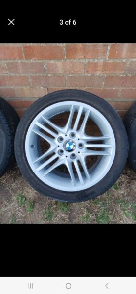

Will these wheels fit my 1999 Z3?

I think they are style 89 wheels. Not fitted originally on a zed. They might fit depending on the size and offset. If you post the wheel size and offset someone might be able to help. The offset might be on the rear of the wheel

Certainly looks like style 89
Whether they will fit your zed will depend entirely on what type of style 89 they are
As you can see came in 17 18,19 inch options fitted to 3,5 and 7 series
Out of that lot only the e46 8×17 et47 is a straight fit the rest have major offset issues especially on the front axle.
So if stamped on the wheel 8 x 17
Et 47 all good .

Thanks Stephen. So if the 89 wheels say 8x17, etc 47, then all good, and a straight fit?
