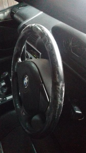

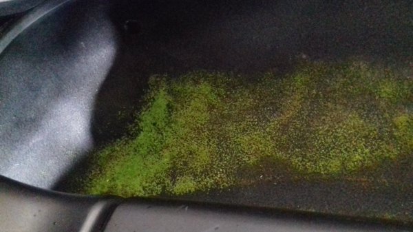

After all that, turns out I don't need to. What sun there is in Scotland is shining right in the windscreen these days. Dried up lovely in the last ten days. No smell even - Result! Only mould left is on the steering wheel
Now I just need to find where the damn leaks are from.
