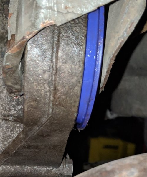

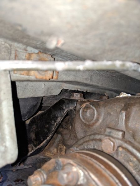

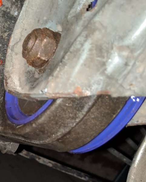

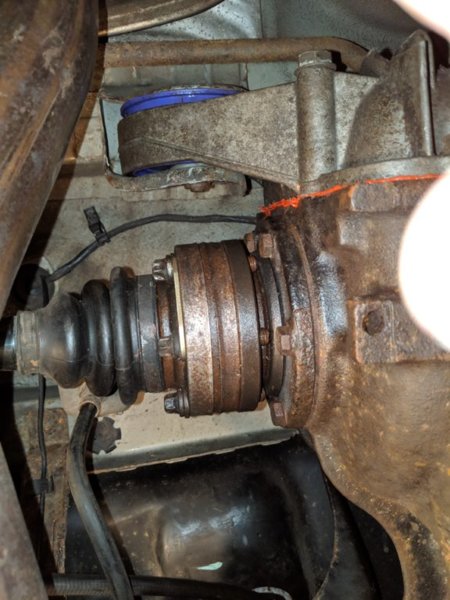

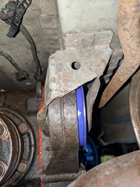

Why does my powerflex diff bush not sit as expected?

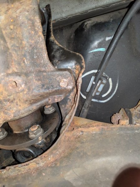

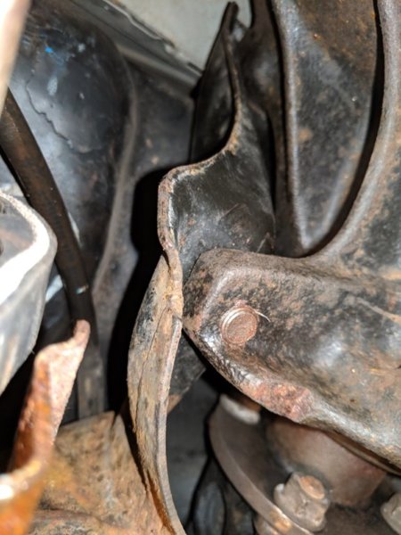

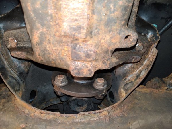

I would also lift the boot carpet and check the spot welds for the box section the different carrier bracket is part of that nothing is dislocated.

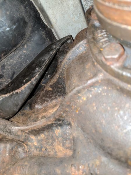

Alright, thank you so much everyone for the input. I have to bleed the left caliper tonight and put the wheels on in prep for tomorrow. The mounting posts for the subframe don't seem to have moved and the control arm on impact side is a low mileage replacement so the alignment shouldn't be too poor.

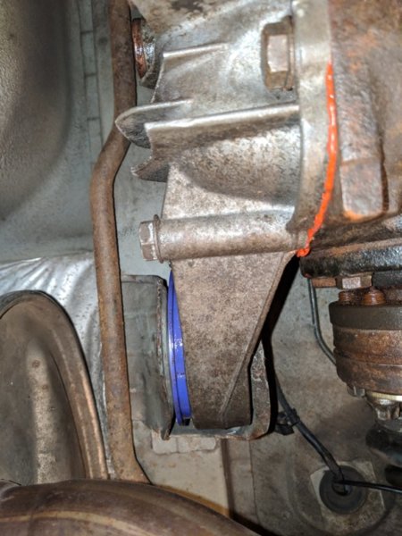

The rear beam is held on by 2 pins, one on either side of the car, if one of these is bent, or the Bush has collapsed then you would get this type of deformity.
