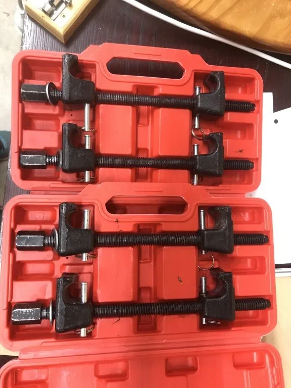

I used these spring compressors. A nice small form factor that allowed for all 4 to be on the spring and get it compressed. They worked well.
