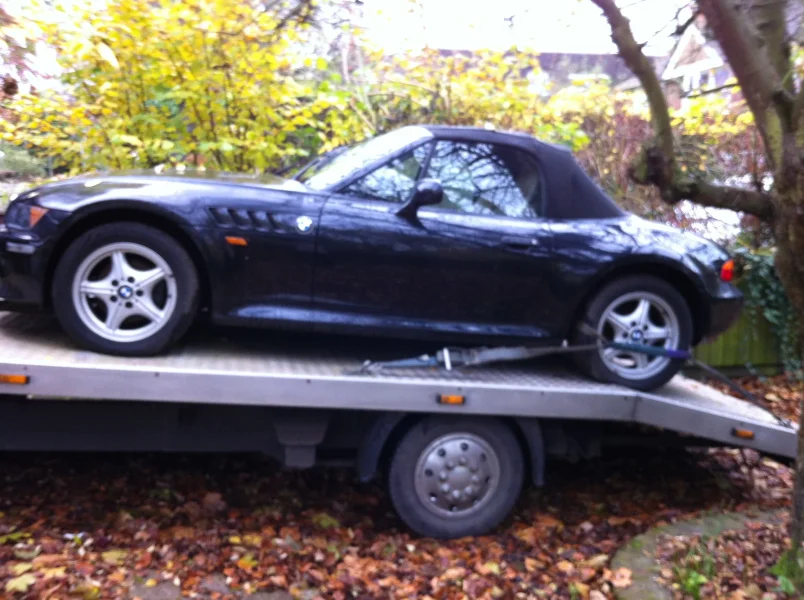

If my poor It skills have worked there should be a picture of it forlorn on the back of a low loader on the way to its current abode. I'll take some more when it stops raining...
Bit of air in that rear tyre and she looks good for the road ;)
