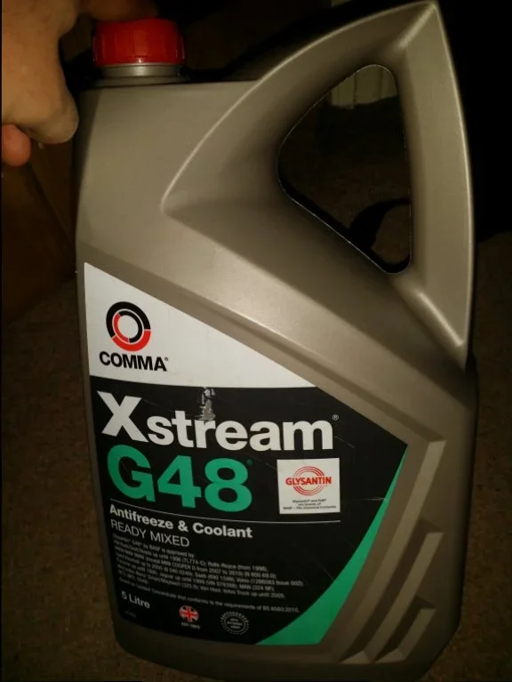

Personally I use Comma Xstream G48 (was Glysantin Protect Plus G48) which is on the BMW approved list (it's green/blue).
The attached document shows the approvals list but somebody may have a more up to date copy as the list and trade names do change.
