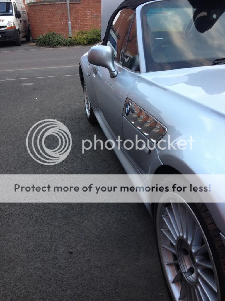

Just finishing off now, but here you can see the gap to be bridged in the short term while i sort out correct offset wheels:

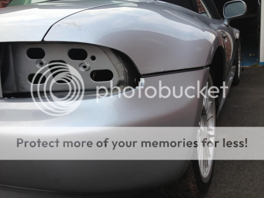

Just the final bumper fixes to go on and then its a case of adjusting the shut lines, but most panels have gone on perfect. It was my intention to have the panels repaired and sprayed off line, how ever after numerous conversations and a visit to Fuzz Townshend the repairs will be done in situ with a full re spray at a competitive cost over the winter hibernation period.
