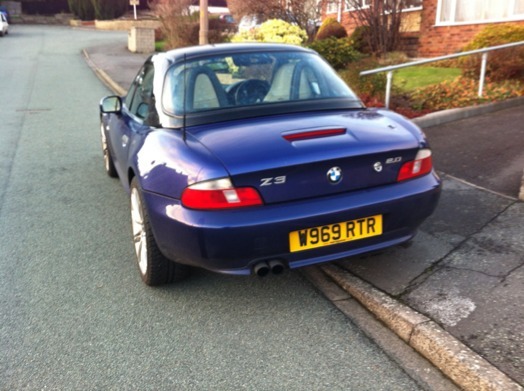

Got the spacers & fitted, they are just right. Thanks for your help & advise :)
Heres a quick pic, its a bit hard to tell by the pic cus it was took on my phone in the dark & before anyone says it, yes it needs washing.

Looks brill ;)
Now get it washed!! :eek:)
