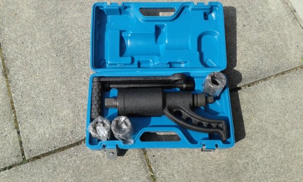

After a very stressful and unproductive day last weekend attempting to remove my front wheels to replace the ABS sensor I decided, after a bit of research to invest in a torque multiplier, l know they are primarily intended for commercial vehicles, but my wheel bolts were not for moving, I tried a blow lamp, impact wrench, impact driver and extension bars etc all to no avail, but this great piece of kit made the job a piece of cake ! And i can strongly recommend their use to anyone, and at a cost of about £40 I don't consider it very expensive. Hope this info may help someone else who may be struggling with the same issue.
