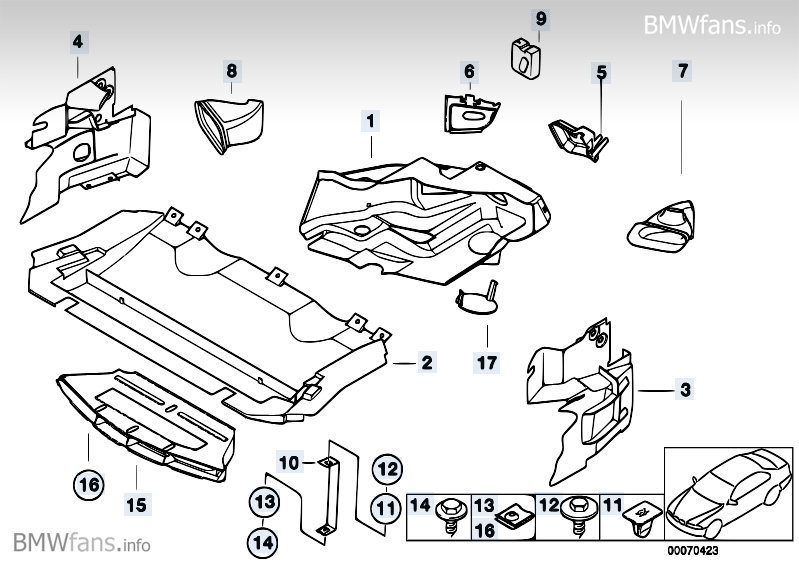

    Hi Guys, Please refer to attached photos.
    The fog lights were removed by someone in the past and now I have this black plastic insert in the passenger side [the driver side is missing]. On the drivers side you can see the clips [circled] as part of the bumper but where do the fog lights secure in there? It doesn't make sense. Has the entire bumper been replaced from a 3m or something? Any detailed assistance appreciated.

    This does not look like a standard bumper Cooper, can you post an pic of the complete bumper pls?

    Oooh, you have an ///M bumper. That's an unusual bonus, except that you can't fit fog lights to them easily!
    Good spot @Brian H

    Yep as Gary states you have an ///M bumper fitted to your car, AFAIAA there are no fog lights that fit that bumper, the plastic ducts are air duct to help cool the front brakes.
    Part 7 & 8 are the ducts on the drawing below:
    [​IMG] Air duct - BMW parts catalog
    • Like Like x 3

    Hahaha. I actually wrote the the previous owner about this a long time ago because the vehicle came with fogs and still has the switches and the wiring. I read that the M had the inserts to deflect the air to the brakes. He never answered me back so I left it as that. Well there you go. I will forget about the foggies!
    Thanks guys!
