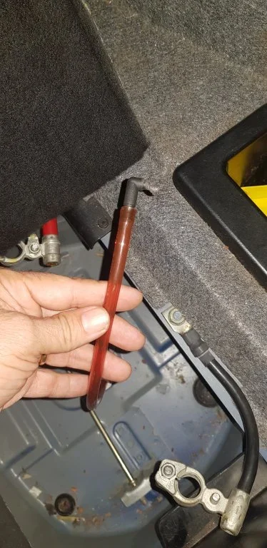

What is this small tube? [pic inside]
danielfb
Sep 12, 2023
13
I tried to replace the battery and found this tube hanging around in the battery compartment.
Any clue about what is it?
Some batteries have a breather tube which allow any gases released by the battery to vent outside of the car boot. Not all batteries have them.
TriumphZ3
Aug 2, 2023
39
As Tony says it's a breather tube. Look around the top edge of the battery, there may be a small hole that it fits into in one of the side faces near the top..
