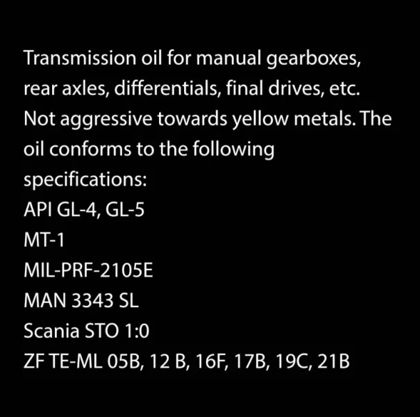

Zephyr
Aug 10, 2022
136
I have no idea of what this is.
You should ask specifically for a manual transmission oil and a differential oil.
May be the same in terms of viscosity but may be different in added ingredients.
Try finding one that complies with BMW standards. The one you posted seems to be for a truck.
