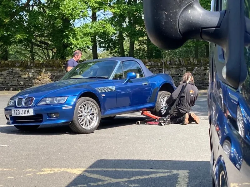

Yes it finally happened to us while in North Yorks.
Parked up in Leyburn after a good Ron up the A1 followed by a tootle
round Masham and Middleham . Lovely day ,weather just right top down
all day When I noticed the dreaded flat tyre ,near side rear,not sure when it
happened ,didn’t feel it at all.
What to do next??? Boot full of luggage,Julie in the front seat,I do have the spare wheel
but the old problem .......nowhere for the punctured wheel ,what a stupid solution to a
puncture .Tried to inflate the tyre but it was having none of it, stuck !! What would you do?
No points for leaving Julie behind !!

AA to the rescue was the answer on this occasion!
Had to come to the conclusion that I had no spare wheel .
Came to the rescue within 20 mins but had lots of trouble finding
a new tyre. The punctured One was down to the wire on the last 20mm
on the inside of the tyre which when we found out it was almost the full circumference of the tyre .Frightening to think 30 mins before I was doing
70mph 😉on the A1.Thankfully the wheel is OK Paul due to the fact the tyre
was a run flat which I never knew.
Eventually found a part worn at a local garage so it was on the back of the
recovery truck and had the tyre fitted.2D5290C0-D86B-453B-A61A-ACE75AF5CC40.webp
