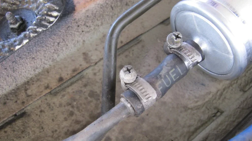

AntStark Zorg Guru (III) Supporter British Zeds Joined May 15, 2021 Points 139 Location Hampshire Model of Z 2002 3.0 Sport May 6, 2023 #1 What’s this blue canister thing ? Thanks
colb Zorg Guru (V) British Zeds Joined Nov 25, 2012 Points 178 Location Newport, South Wales,UK Model of Z Z3 M43 1.8 (1999) and Z4 E85 2.5 (2003) May 6, 2023 #2 Looks like the charcoal filter from the fuel tank RealOEM.com - Online BMW Parts Catalog BMW parts Z3 E36 Z3 3.0i Activated Charcoal Filter/TUBING www.realoem.com

jonco Zorg Guru (IV) Supporter British Zeds The M44 Massive Joined Dec 6, 2011 Points 159 Location Chester Model of Z '98 1.9 Auto May 6, 2023 #3 On the M44 it's a cartridge filter and has flow direction and FUEL labels on connections. You may be able to see them up close. Attachments CAFE4A01-5C6C-4C48-BB8C-BDE92567E752.jpeg 91.1 KB Views: 11
colb Zorg Guru (V) British Zeds Joined Nov 25, 2012 Points 178 Location Newport, South Wales,UK Model of Z Z3 M43 1.8 (1999) and Z4 E85 2.5 (2003) May 6, 2023 #4 Fuel filter is mid car running longitudinal on my M43 his picture shows running lateral across the car that's why I suggested charcoal filter

jonco Zorg Guru (IV) Supporter British Zeds The M44 Massive Joined Dec 6, 2011 Points 159 Location Chester Model of Z '98 1.9 Auto May 6, 2023 #5 colb said: Fuel filter is mid car running longitudinal on my M43 his picture shows running lateral across the car that's why I suggested charcoal filter Click to expand... Ok - sorry mis-read original.

AntStark Zorg Guru (III) Supporter British Zeds Joined May 15, 2021 Points 139 Location Hampshire Model of Z 2002 3.0 Sport May 6, 2023 #6 Yes it’s not the fuel filter, just had that done
NZ00Z3 Zorg Guru (IV) Supporter New Zealand Zeds Joined Dec 9, 2014 Points 158 Location Timaru, New Zealand Model of Z 3.0L, 2.8L, 2.0L Z3 Roadsters May 6, 2023 #7 The blue item is the ABS wire connector. Nicely tucked away in it's plastic holder The L shaped hose is the one that goes to the charcoal canister
Andyboy Zorg Guru (II) Joined Jun 2, 2019 Points 119 Location SHEFFIELD May 7, 2023 #8 It's the ABS sensor clipped into its plastic housing which is missing the cover, allowing road filth and water in. New ones are 61138367936 right hand/driver side and 61138367937 for the left one.
