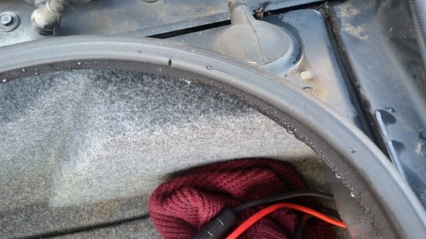

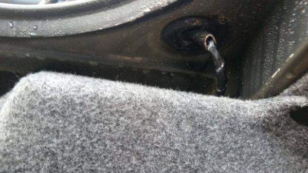

The wetness in the boot seems all left-hand side. The aerial seal on top the wheel arch seems sound so must be the secondary into the boot?
