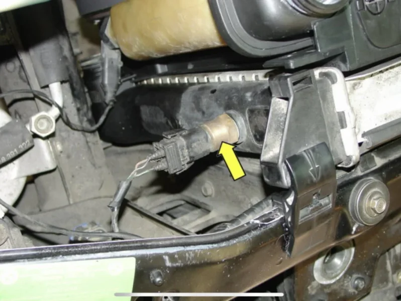

Hi there. I have a 2000 z3 2.3, 6-cylinder. I just replaced most of my cooling system including the radiator, fan, coupler, water pump, thermostat and housing, belts and tensioner. It seems to be running ok but the water temp meter is now stuck at 12:00 when the engine is running.
I understand there are actually two water temp sensors, but I am not sure which water temp sensor actually controls the gauge:
a) the one on the side of the radiator?
b) maybe something associated with the electrical connection right at the thermostat housing?
c) or maybe somewhere else like in the intake manifold? I didn’t mess with that one.
the sensor in the side of the radiator has a very stubborn connector and it’s possible I could have a broken a wire in the connector end. The little bellows would not slip inside the sensor. It doesn’t appear that any pins are bent though.

The sensor on the side of the rad is for the hi temp and activates the electric aux fan at the front of the rad (AC fan) did you change that?
If so then some have an extra bit of plastic in the plug connector area that stops the plug engaging if you look you will see it, I've had this problem. You need to remove it then the plug will seat correctly. Or its the the plug that has the extra bit can't remember, there is a post on here somewhere showing this issue.
If its not this then I would say it the thermostat wiring\plug.

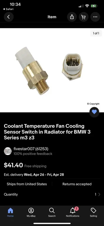

And the thing on the side of the radiator is described sometimes as a switch and sometimes as a sensor, but has nothing to do with the temp gauge? I did not change the AC fan.

Hi I know what the sensor in the rad side is. My point was if it's been changed and it the same as mine and the plug isnt connecting correctly then maybe a circuit is not being made in the system somehow? It was just a thought as you mentioned the plug wasn't connecting correctly. Can only work with the info you provide.

Sorry, I don’t. Does the sensor in the radiator affect the gauge reading directly by measurement or only indirectly by switching the AC fan on?
