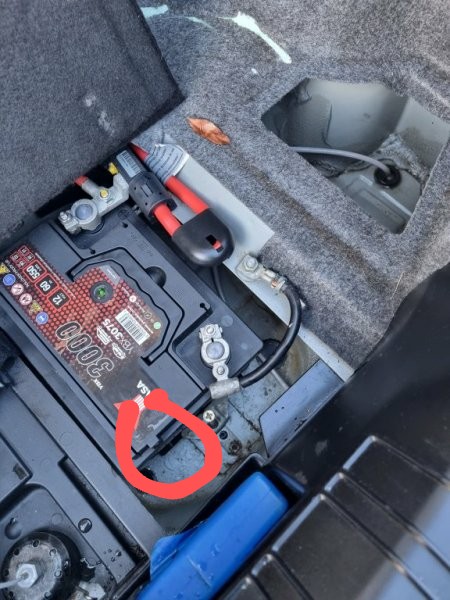

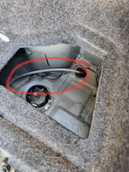

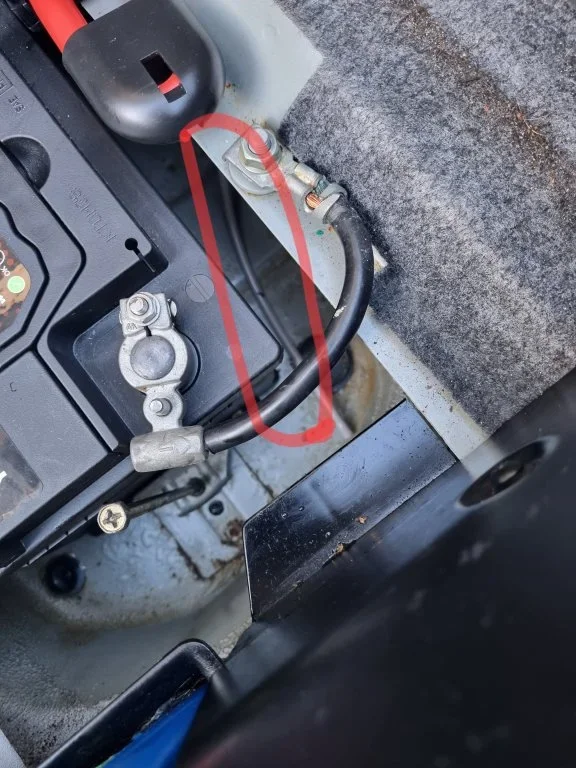

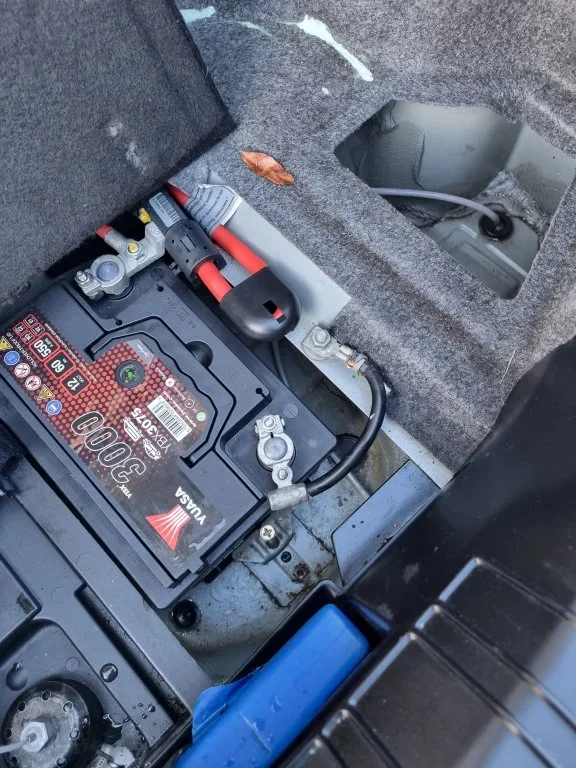

Battery compartment seem to get water collected from somewhere. Can't see any leaks from the middle break light area or on the carpets on the boot. There is also a small rubber tube that seems to have got disconnected from some where.
Any idea what this tube do and how the water get collected?.

The tube should be connected to the battery as below and the other side blocked off

Don't think my battery has that vent hole.
But the water ?
