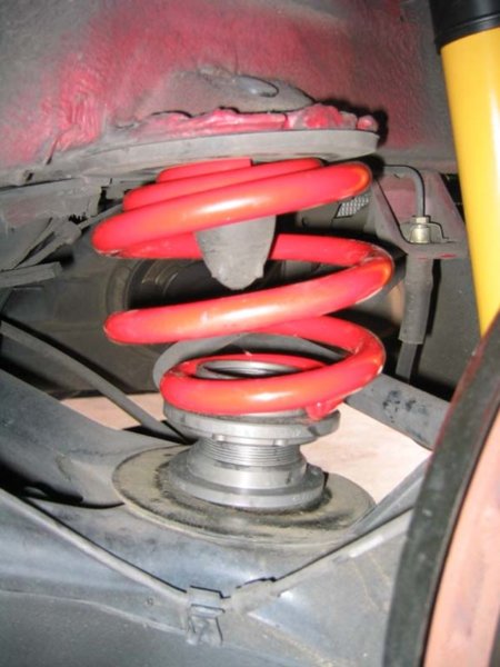

The car is in the mechanics garage so unable to get a pic at present but found the below on the tinterweb. Basically we currently have it installed the opposite away round to the below as it's the way that's stated in the instructions. Anyone else have Vmaxx coilovers or similar to see how this compares to others.......failing this we will try to fit as per below image and see...

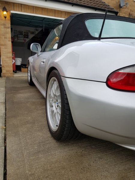

Right, had confirmation from both Venom Motorsport and Vmaxx themselves that the only difference us the springs. Springs have arrived and now fitted and all is good.
Richard at Venom Motorsport has done all he can and would defo use them again. I'm old and wise enough to realise that mistakes happen but the difference is what happens when the mistakes become evident and for that Richard has been great.
Anyway pics

Looks great :thumbsup: Sitting perfect now.
Did they say what springs are needed then and from what model? And is there anymore adjustment with them?

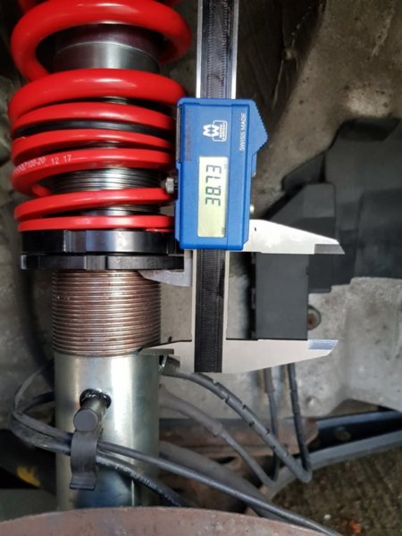

There is about another 5mm to be had at the back and the front would go lower. Pic below of where I've currently got it.
