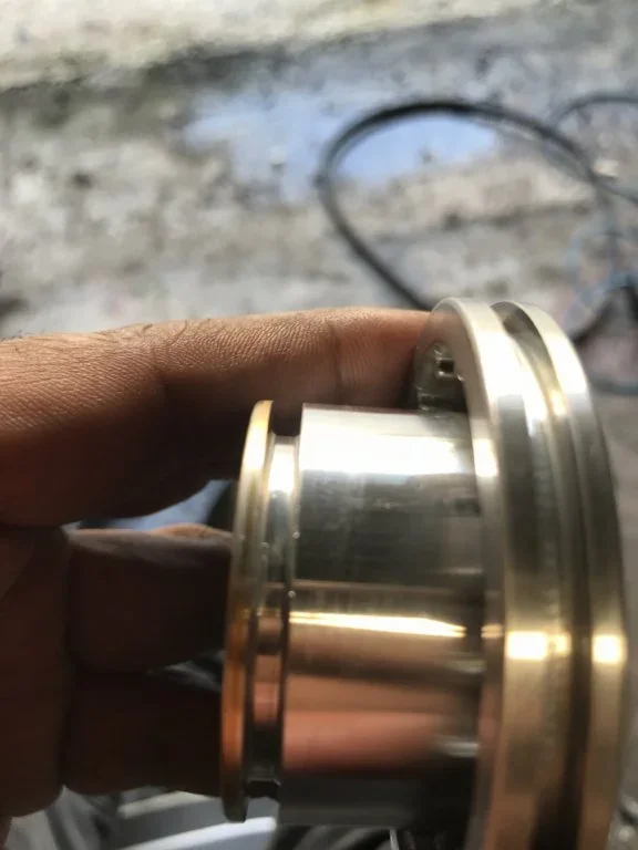

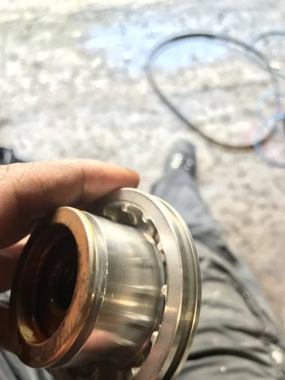

So I’m halfway through it. Changed the belt while at it. I was very careful taking the old seals off the pistons but I found these marks on one of them...probably the worst one.
I’m just waiting on delivery of a couple of items but can these but sanded back or is it completely ruined??
