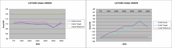

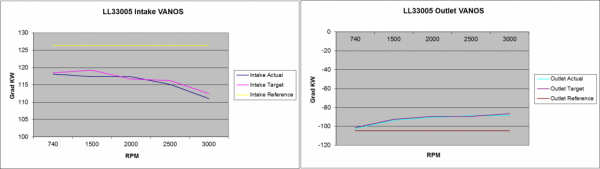

The first chart (LL33005) is of a working VANOS on a very low mile 3.0 L Z3, so you can see what it should look like.
The second chart (LG73383) is of 2.0L Z3 with 100,000 miles on the clock before seal replacement. Still not bad but here was a noticeable performance improvement after the seal replacement. Didn't do a post repair logging. Testing done with a stationary car, just reving up the engine.
Great to have those graphs thanks. The VANOS seals will get done anyway but I like to have all the background knowledge too.
