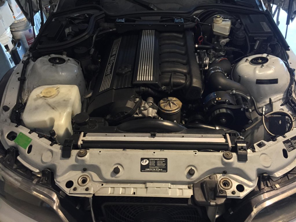

There are two different engines with the 2.8 L label. I'm going to get into a little bit on engine history to hopefully stop this thread getting confused between the two 2.8 L engines.
The first and most common engine was the M52B28 and it had single VANOS on the inlet cam only, see photo, look at the front of the valve cover to see the differences. This was a on/off valve timing change at around 3,000 to 3,500 rpm. Worn VANOS seal leaves the car sluggish when driving above that rev range when it should have switched over.
