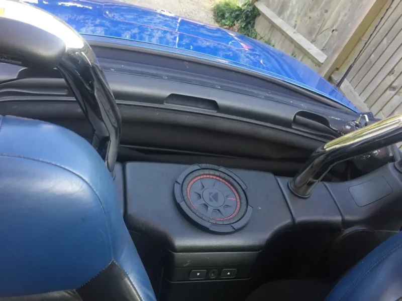

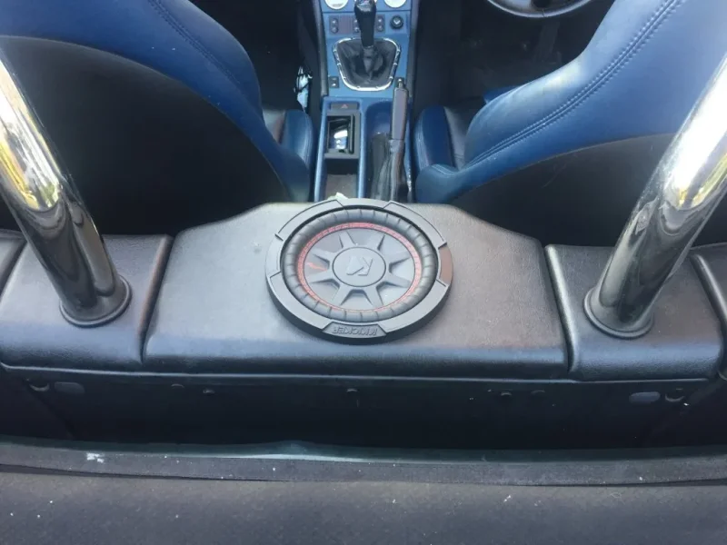

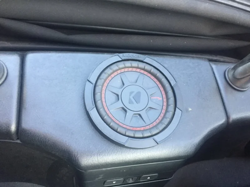

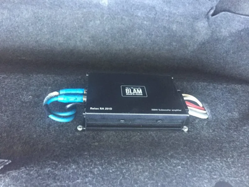

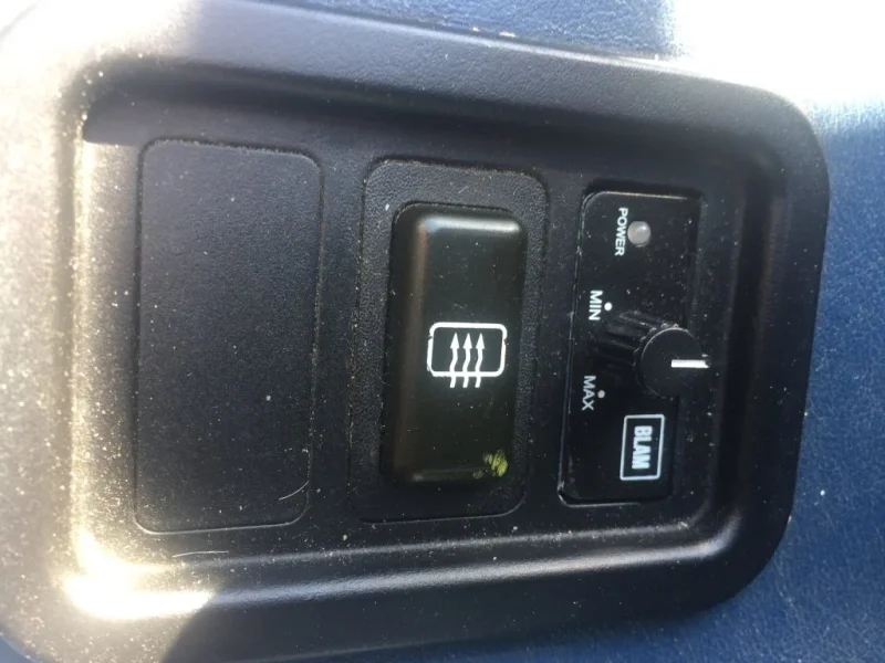

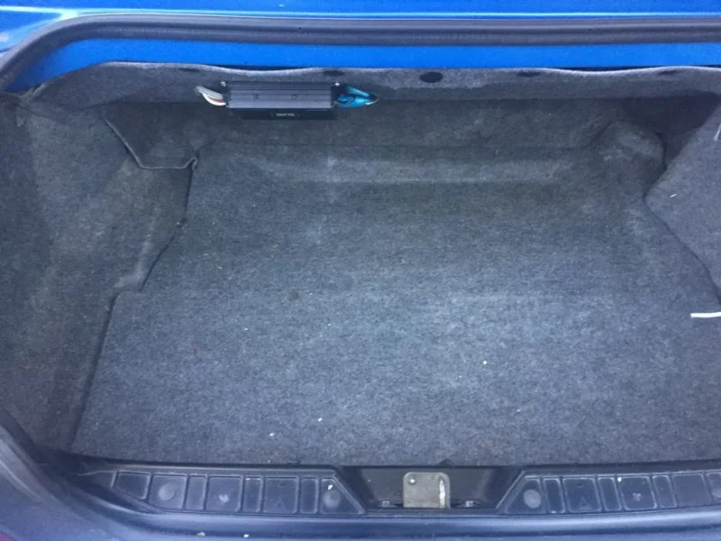

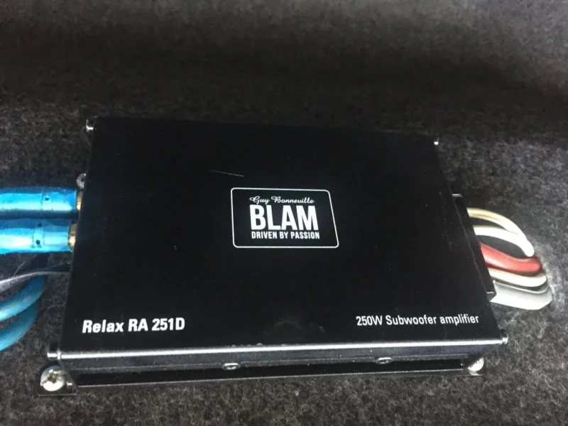

Hi ,
Finally finished upgrading my Z3 sound system, as I only had the standard set up , not even the the Harmon Kardon upgrade. I started by replacing the original front speakers with a set of Pioneers, and adding an extra pair of Pioneers behind the rear seats. I also upgraded the tweeters. Then it was the big job of adding a sub woofer. I was advised by my local specialist car stereo firm to fit the Kicker Sub as it needed the least volume for the enclosure. As well as polyfill ,It still needed the lid to hold the sub to get the absolute maximun volume so it entailed me fabricating a new lid to fix the sub to, and then to cover it in leather. I also covered the adjoining plastic covers to give it a bit more of an OEM feel. I fitted the 250 watt 2ohm Blam mono amp in the boot which also came with a remote gain control which I decided to fit adjacent to the rear heater button. I have now set it all up and cannot believe the improvement in the sound.!!!!!

My CD changer never failed and Its only a small amp so fingers crossed. By the way I upgraded the head unit with a Kenwood unit

Hi, so is that just a new lid and the storage compartment filled with polyfil ( for cushions)? Looks great btw
Any rattles?
bob.c
Jan 26, 2017
49
Any rattles?
Hi Trevor, Its a new lid that I had to fabricate together with a new enclosure that replaced the existing compartment. No rattles ,no amp overheating and the sound is just incredible .Worth all the hassle.
