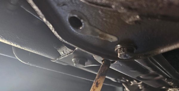

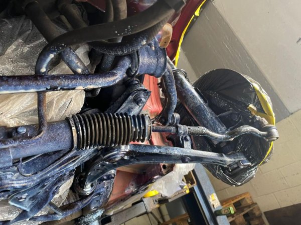

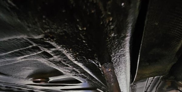

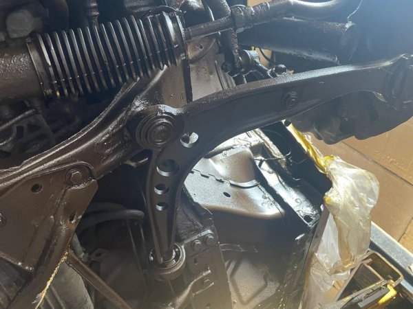

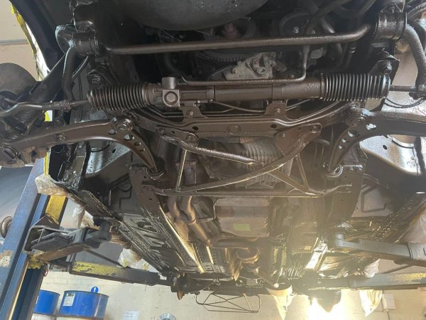

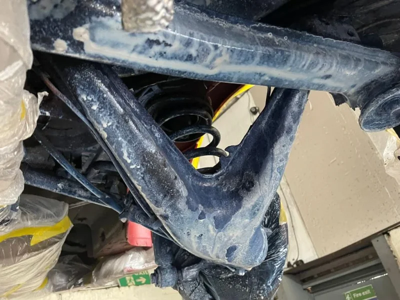

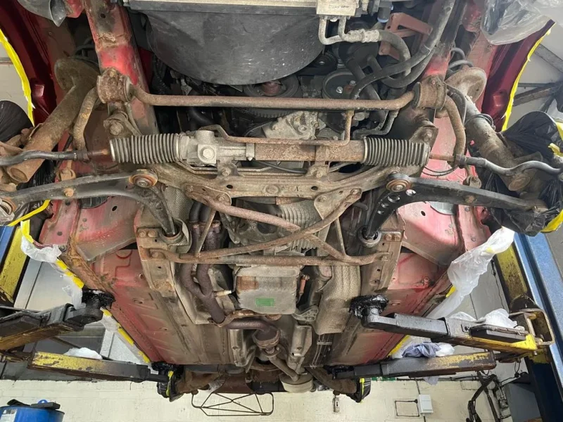

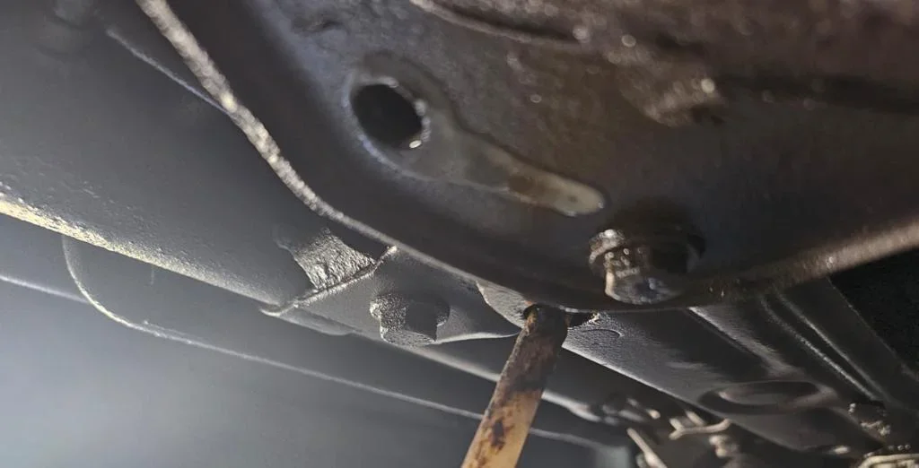

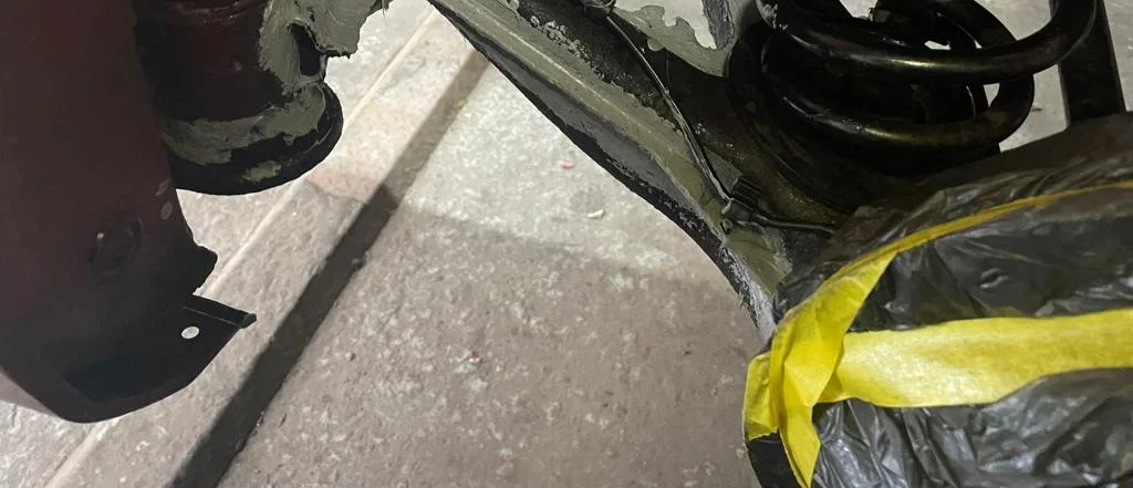

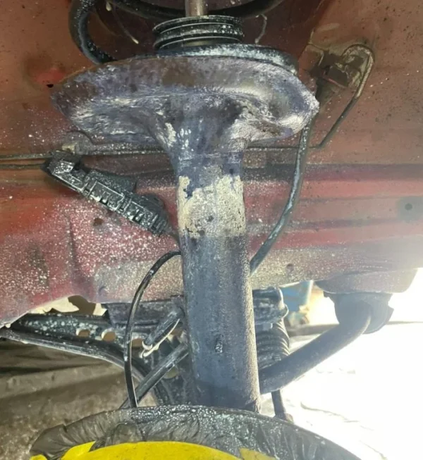

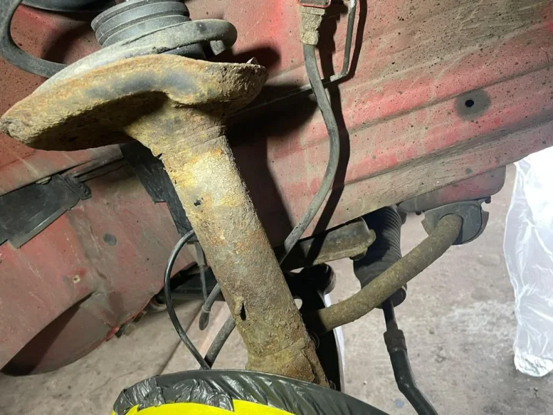

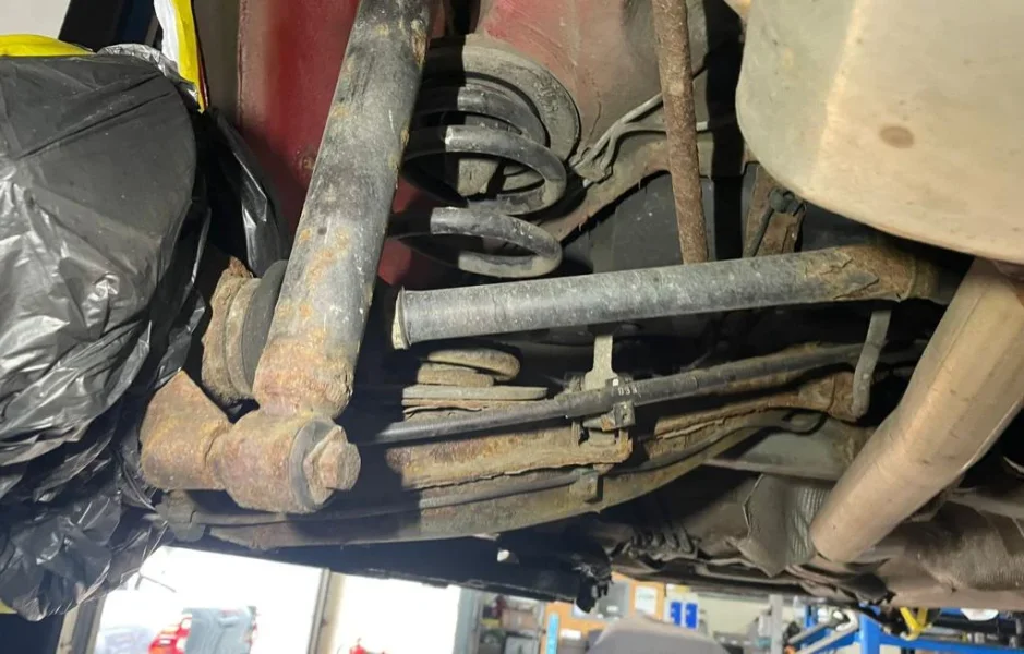

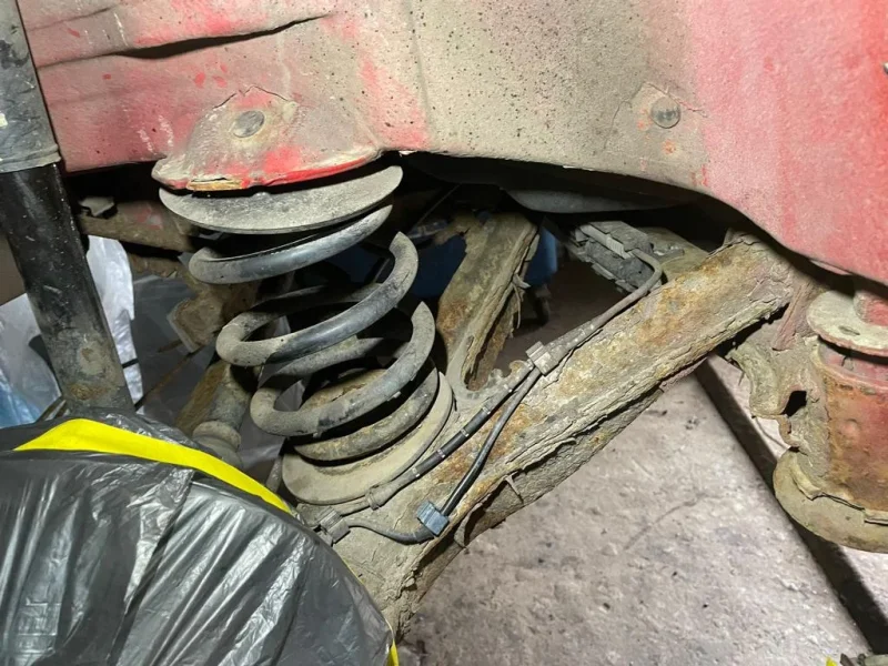

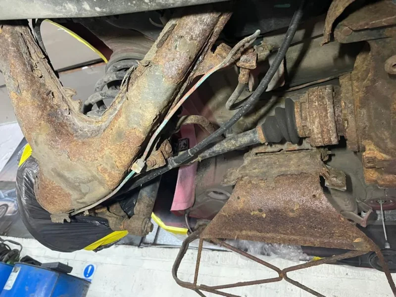

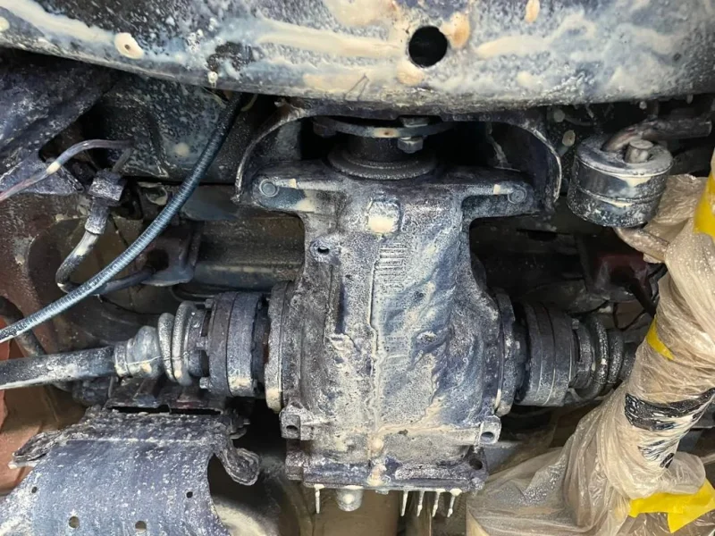

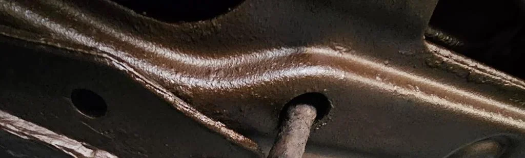

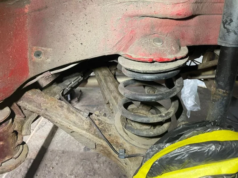

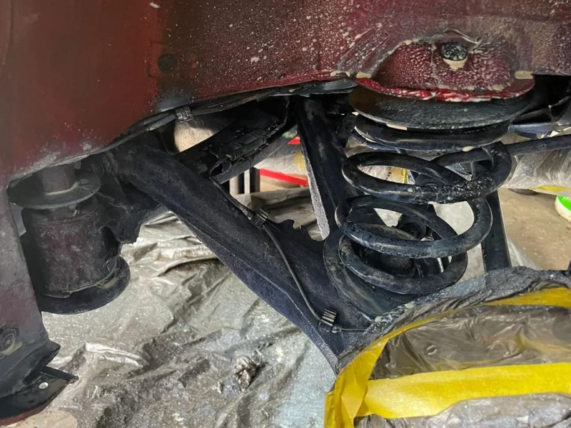

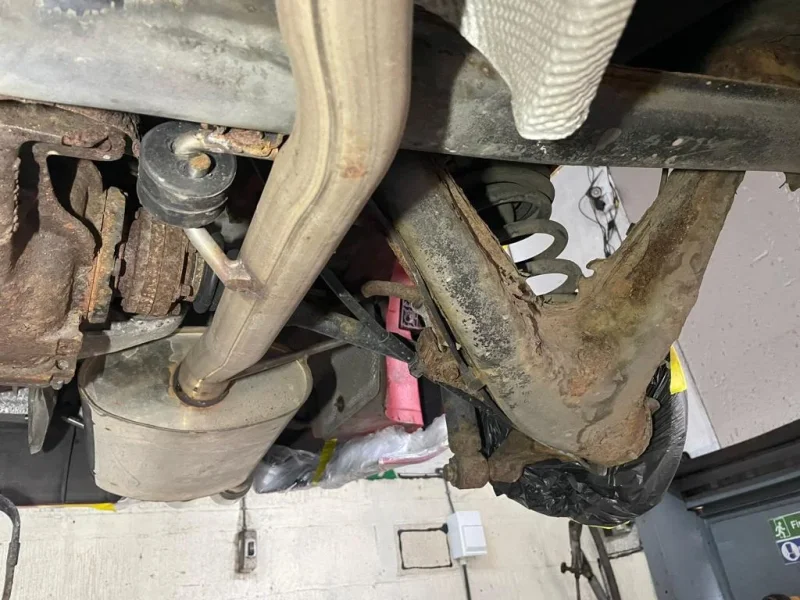

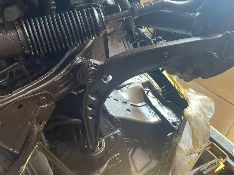

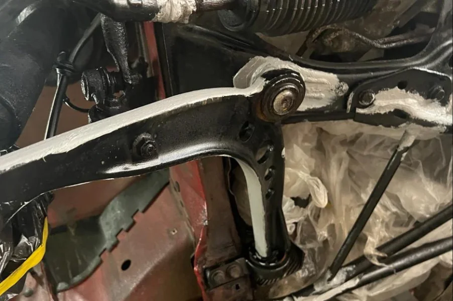

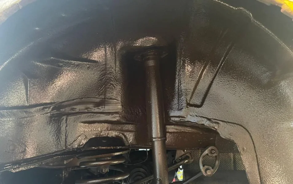

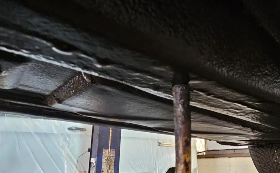

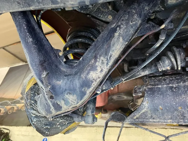

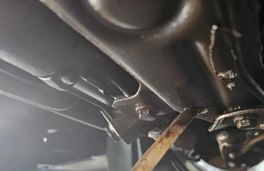

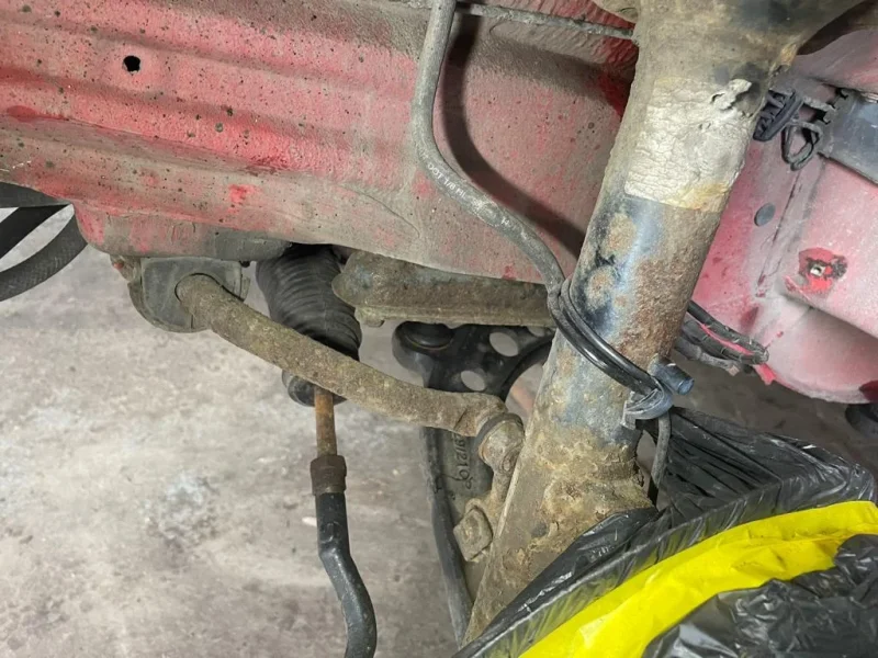

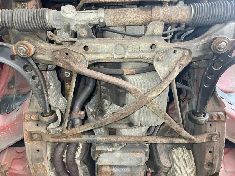

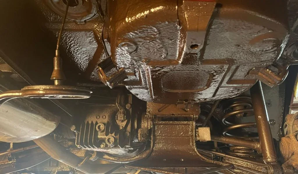

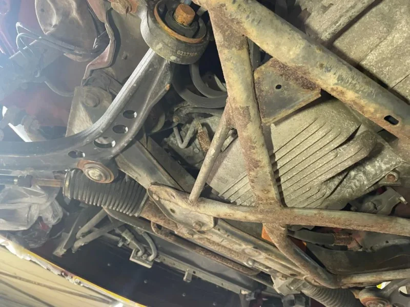

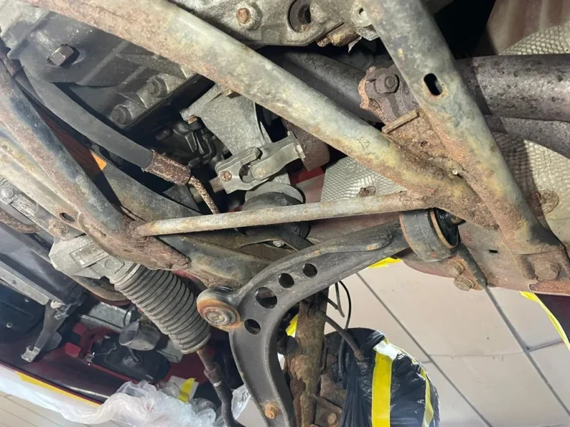

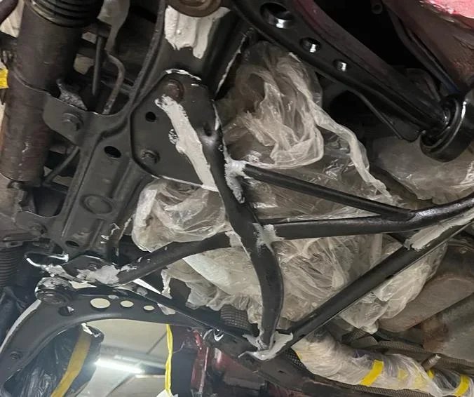

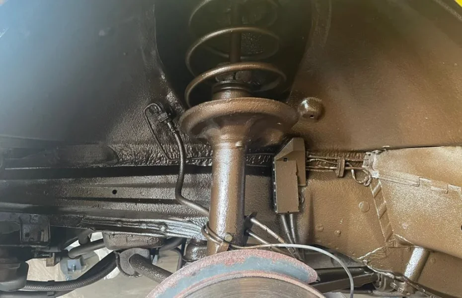

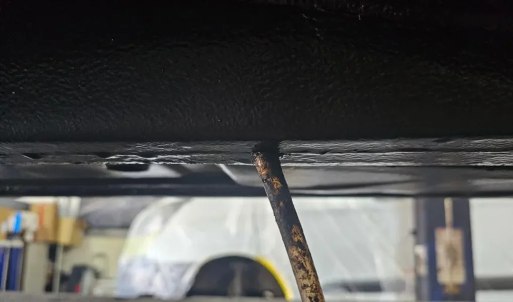

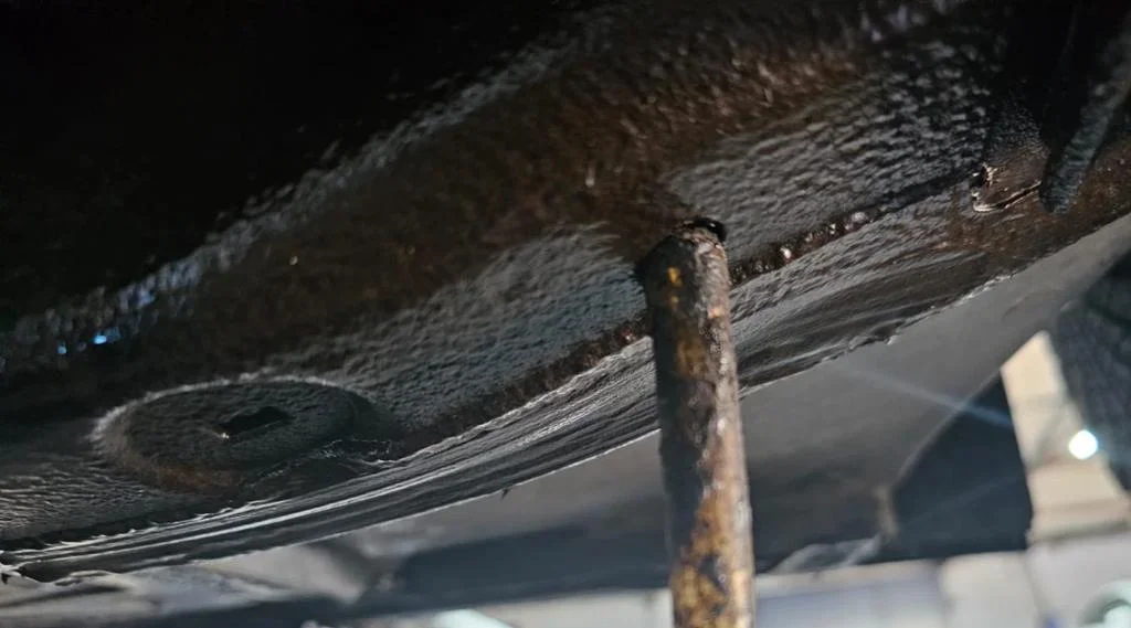

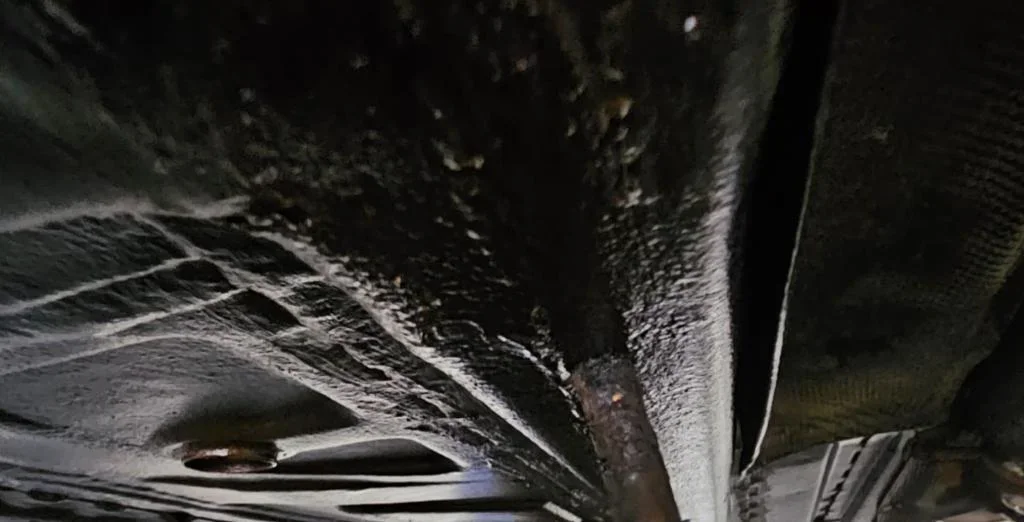

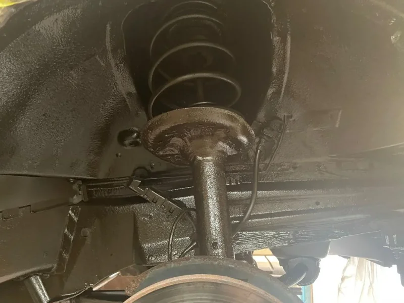

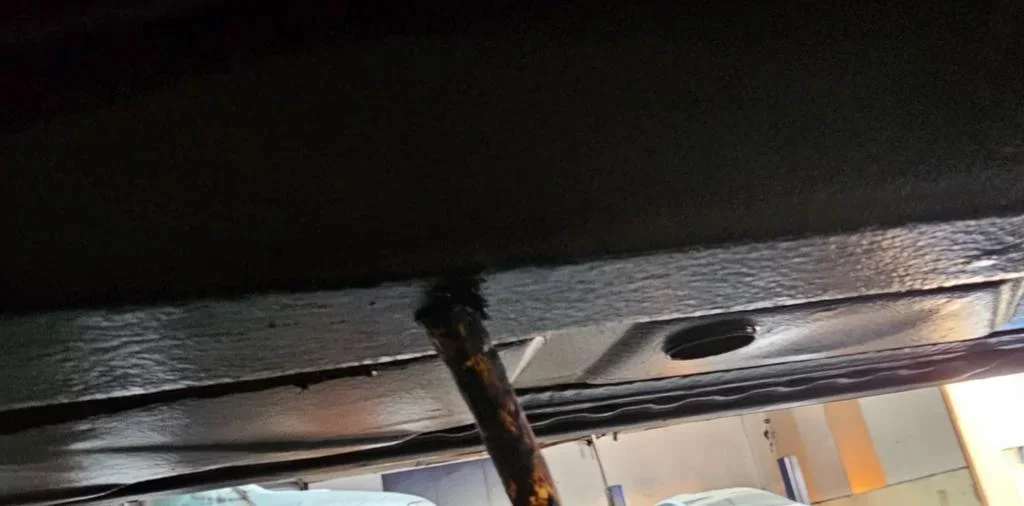

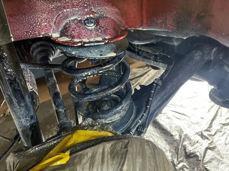

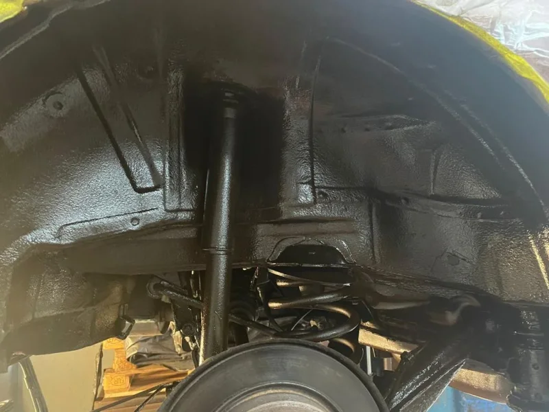

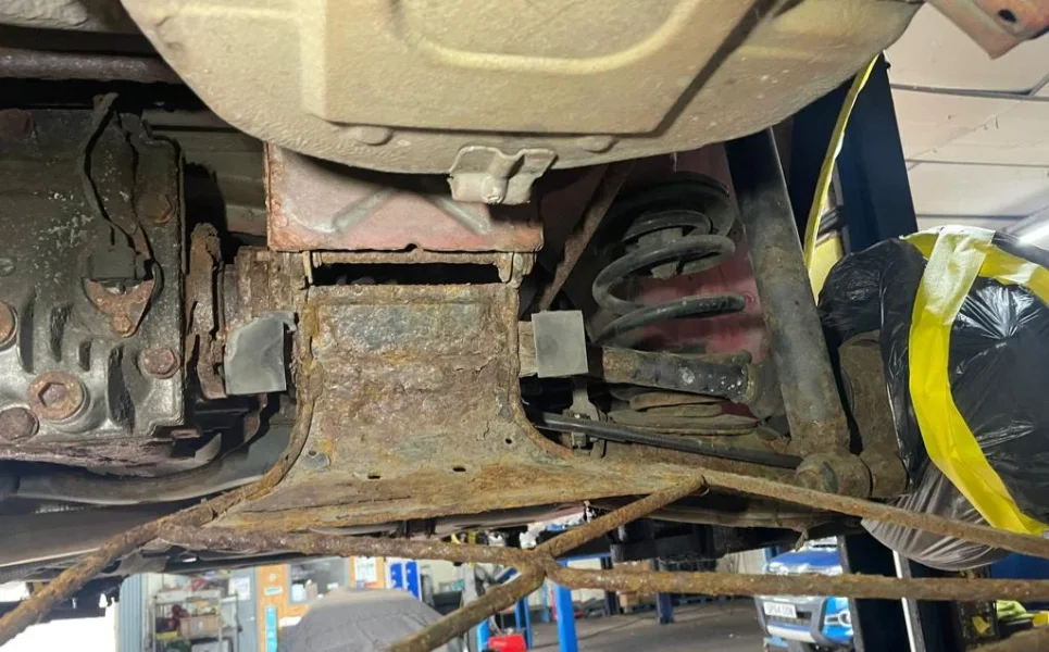

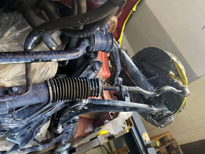

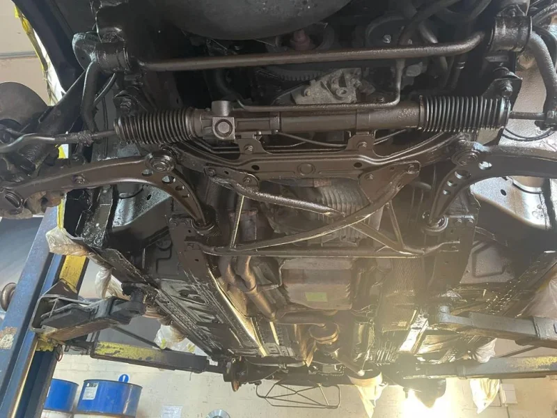

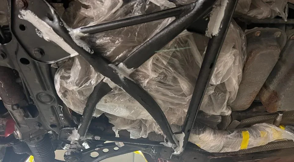

Got underseal done at a place just outside of Glasgow. Before and after Part 1

Looks great! I made the heinous mistake of clicking on a Lanoguard ad on Facebook a week or two ago, and now I am getting totally spammed with them 🤦‍♂️ It is working though, as I am considering getting some and applying it later this year...
I'd be interested to compare DIY vs. a garage - Do you mind if I ask roughly how much you paid? And did that include the surface prep?
Stages were:
Needle descale
Steam clean
Rust converter
Weldseal application
Primer
Wax
Cavity wax Injection
Cost was £750 + VAT
oh wow, they have done a proper job then!! Thank you :)
Also got a Kia Sportage GT Line S done (3 years old and they found spots of rust underneath) and a Motorhome (3 months old).
I live on the west coast of Scotland which due to the salty air and grit they use on the roads is the worst place in Europe to own a vehicle!!!
