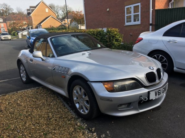

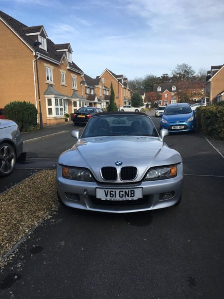

Hi,
I'm new to forums so please forgive me if I get it wrong :)
I've just bought a 1999 Z3 2.0 project car. I call it a project car as I can get it to start yet.
Any help you can give would be gratefully received
