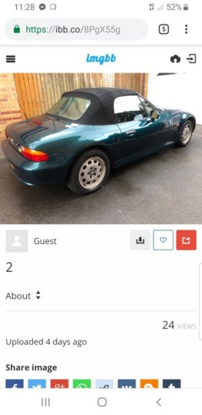

Hi all, getting very confused! Bought Z3 today, it's got alloys on it that look like steel wheels and they are 15" . it's also got two different tyre sizes on it (two new and two that need replacing) 195/55/R15 and 205/60 R15 , these are on opposite corners of the car! Googling tells me that the wheels on a 1997 1.9I are 16" ?!
Thanks for any help, the two new tyres are the 195/55/R15 so hoping these are correct!

15" were standard, 16" an optional extra.
That said, the original "pepper pot" steel wheels on your car are quite rare. I rather like them.:thumbsup:

Thank you, yes they are pretty nice, but they are corroded which is why I was thinking they are alloys?
Is the 195 the standard tyre size?

According to the 1997 price list and specification, the tyres were 205/60 R15

Hi, what does it say on your door post, the tyre inflation chart, there should be some clues there as far as wheel/tyre combinations.
