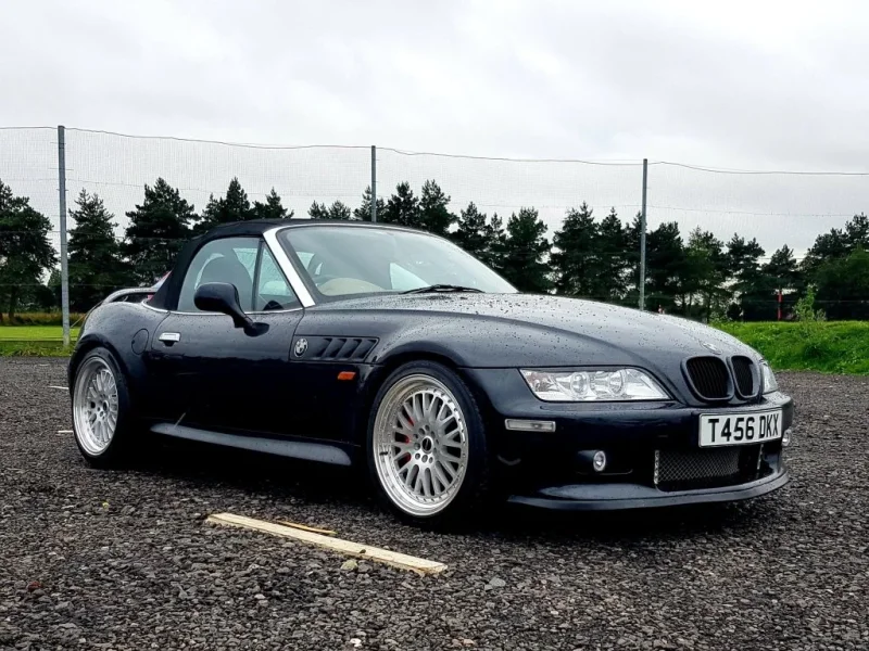

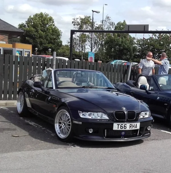

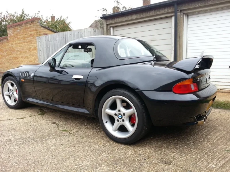

    Heres a couple of pics of my old Z3, first one with OEM 17in, others with 18s + uprated lowered 30 mm suspension.
    The Z4 came out with 18s and most people accepted the ride quality it being a sports car. Best of luck, keep us all posted on what you decide on.

    Hi Tony (bell), the wheel widths were 8.5in front 9.5 in rear with 35 offset, (that's a staggered set up) tyre size for this set up were 225x40x18 front, 245x35x18 rear. This gave me a very slight stretch on the 9.5inch rears but kept the tyre tread just inside the wing with the alloy wheel protruding a few mm outside which was fine for MOT. The very chunky look from the rear was what I was looking for. Looking at the second pic from the L to B run you'll see this (if) a bit exaggerated on the rears. Hope this helps.
