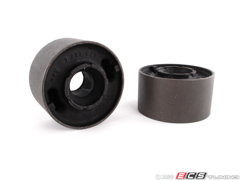

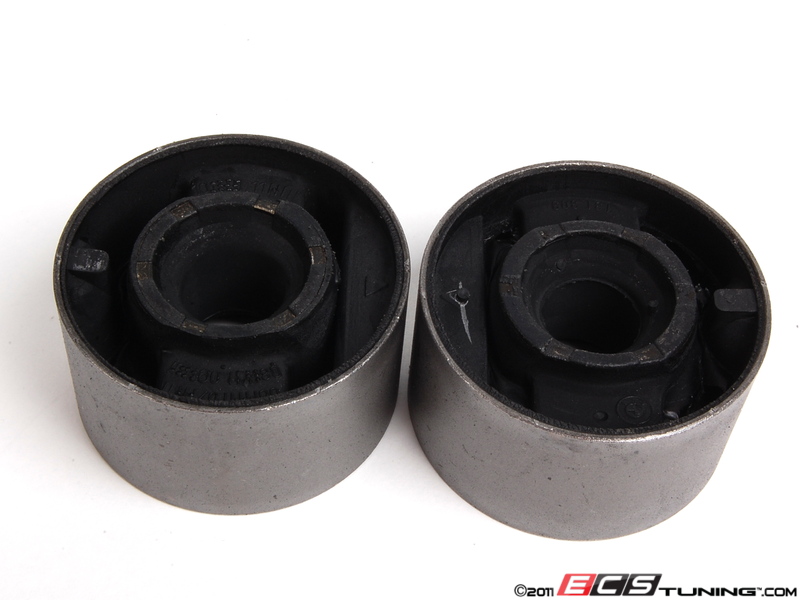

The original BMW design of the front control arm, rear bushing (lollie pop) has lots of air spaces in it. Once they get a few mile in them the are actually quite loose. I fit the Z3M concentric lollie pop bushing part number 31129069035 (no not fit the eccentric Z3M bushing).
Others fit poly bushings to achieve the same thing.
If that does not sort the problem, then turn your attention to the rear suspension. Change the rear subframe and trailing arm bushings to eliminate any rear end steering.
Original Bushing design
Z3M bushing design, part number 31129069035
