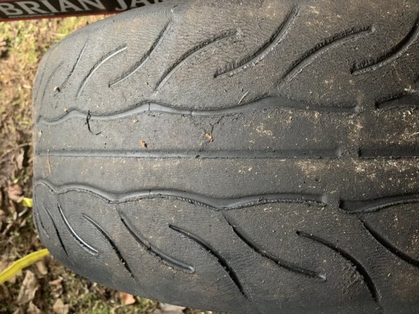

@Dino D sorry for the late reply.
Brake Pads
With reference to brake pads, The only EBC pads I had any joy with were the EBC Blue pads, barring this I was looking at a set (or more) a track day.
I think a totally underated pad is the PFC Z rated carbon metallic pad, best bang for buck I have had on the car, great feel and lasted 3-4 days for me which is saying something.
Tyres
The Yokohama AD08Rs are a brilliant tyre, stiffer sidewall to a standard tyre and will take an absolute beating, I had a set on the Z3 and currently have a set Z4M coming to the end of their life. I originally bought these as a wet weather tyre but have been nothing but surprised with their durability in the dry.
Just keep an eye on your pressures.

Hi Brian -PFC is Perfomance Friction? Heard about them on Pistonheads- where you do get them?
EBC just seems false economy for track at one set per day - happy with yellow on the road though.
Good to hear you like the AD08 - I can’t go for 888 as I’ll drive to track so want to get there and back in one piece if it rains(!) and also still drive on track if it rains midway on a day etc.
If I see the night before it will be total washout then I’ll switch to road tyres..
what sizes have you been running on the Z’s and how many miles do you think you got from them.
The wear looks nice and even - good driving!

The tyre sizes I run on the cars are staggered are sets,
Z3 = 17” 225 front & 245 rear
Z4 = 18” 225 front & 255 rear
I know a good few folks that run square set up but this is something I’ve not got round too. The tyre above is a front tyre, it’s taken a bit of setting up of the front camber to get the wear this even....
