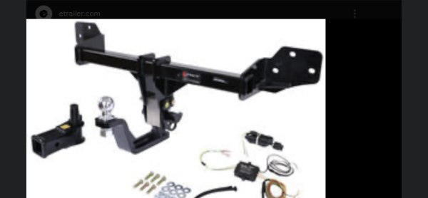

a quick google shows these
Myself I’d go through the bumper and hide it with the number plate. A 50mm receiver hitch and 50mm box section should do the trick, the end plates might take some bending up though.

Following on from the saga of fitting a tow bar to a Z4 I have finally come up with one - the good news - is they are out there (all be it with restrictions) the bad news is that they cost 815,00 Euro + for the wiring kit.
Dear Mr Hamilton,
For this car, we can offer you the following tow bar.
https://www.kupplung.de/anhaengerkupplung-abnehmbar-103408-04924-1.html
Electrical kit: https://www.kupplung.de/ac-elektrosatz-107074-04924-2.html
The thing is, that you have to check, how the conditions are, in your country, meaning, under which conditions you can install them. It`s a special towbar which can be installed under special circumstances.
Over the links, you can check the data as well as the installation instructions. What you now have to do is, to ask the car producer, if it’s possible, to install them.
Für weitere Rückfragen stehen wir Ihnen gern zur Verfügung.
Please contact us for any further questions you may have.
Mit freundlichen Grüßen
kind regards
Buy a length of 7 -core cable and a socket and wire it up your self, or if you can’t, buy the bits and take it to an auto electrician. The one pictured above is for an E89 Z4 not an E 85 Z4 and wouldn’t fit.
