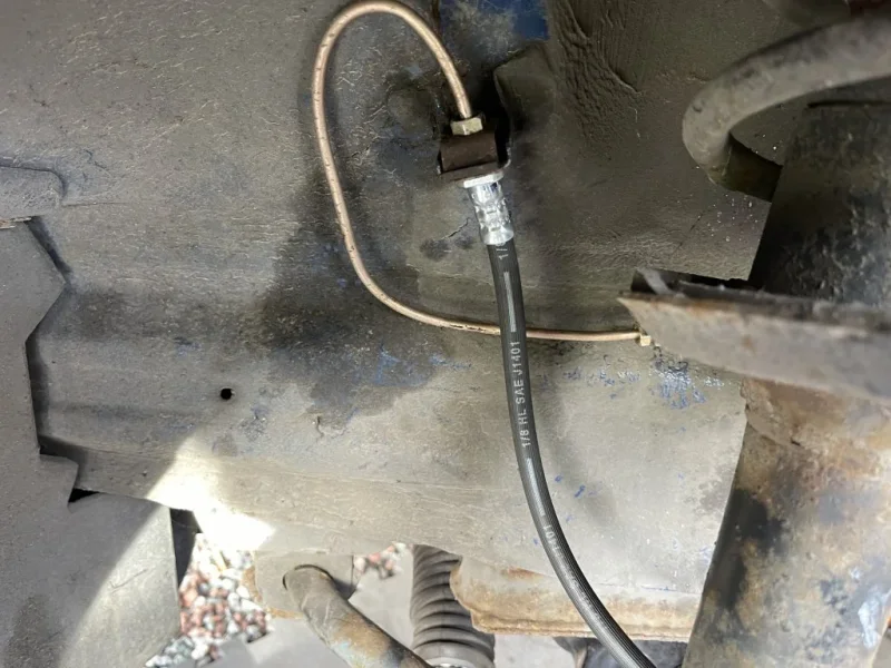

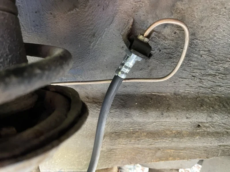

Lamentable - at least that’s my description; I changed the front brakes ahead of the MOT - I wanted to put the join behind the arch liner, but in the end I didn’t - the only corrosion was at the union with the flexible hose.

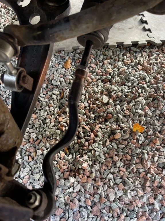

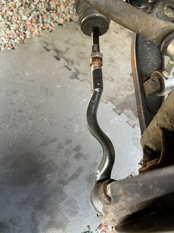

I asked for a pre-MOT and also decided on a TerraClean decarbonisation. Good job I did - track rod ends too much play and would be a failure, and front brake hoses starting to crack.
Changed the track rods and front brake hoses (particularly unhappy bunny as I reckon to have checked them when I did the front brake pipes - yet another brake bleed…..).

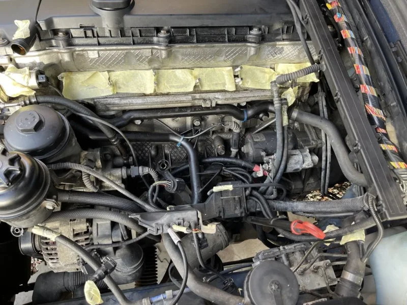

I’ve bitten the bullet and started to remove the inlet manifold - I’ve found pretty much what I’ve come to expect - odd missing nuts etc, but also found a huge split in the air intake hose, and oil in the vanos sensor when I disconnected it. Can someone tell me whether that’s a sign that the vanos seals need replacing?

I followed Pelicanparts how to guide to get the inlet manifold off, lots of labels on both halves of connections so that I stand a chance of putting it back on OK once the starter motor is replaced (which might be a couple of weeks or longer. I’ve found that a lot of vacuum hoses at the rear underneath the inlet manifold are cracked, so as well as new gaskets for the manifold and throttle housing, new air intake hose I’ll see if I can get replacements for those too.
I’ve also attached some pictures of the brake pipes and front brake hoses that I’ve replaced, and a couple of the trackrods I’ve replaced - bizarrely I had a problem getting new cinch clamps for the gaiters in the right size, in the end being nicely surprised at how reasonable the parts prices are. I’ve also included a picture of the 3 switches at the back of the centre console (the blanking plate for one of mine was missing), the only reason for including this was that the BMW Parts Manager said there was an error in the BMW parts diagram with an amendment having been published with the correct part number (which is; BMW centre console rear blanking plate - 51162492136 for anyone else treading a similar path).
If you're careful removing the rack gaiter clips you can easily re use them. Failing that, cable ties work just as well.
