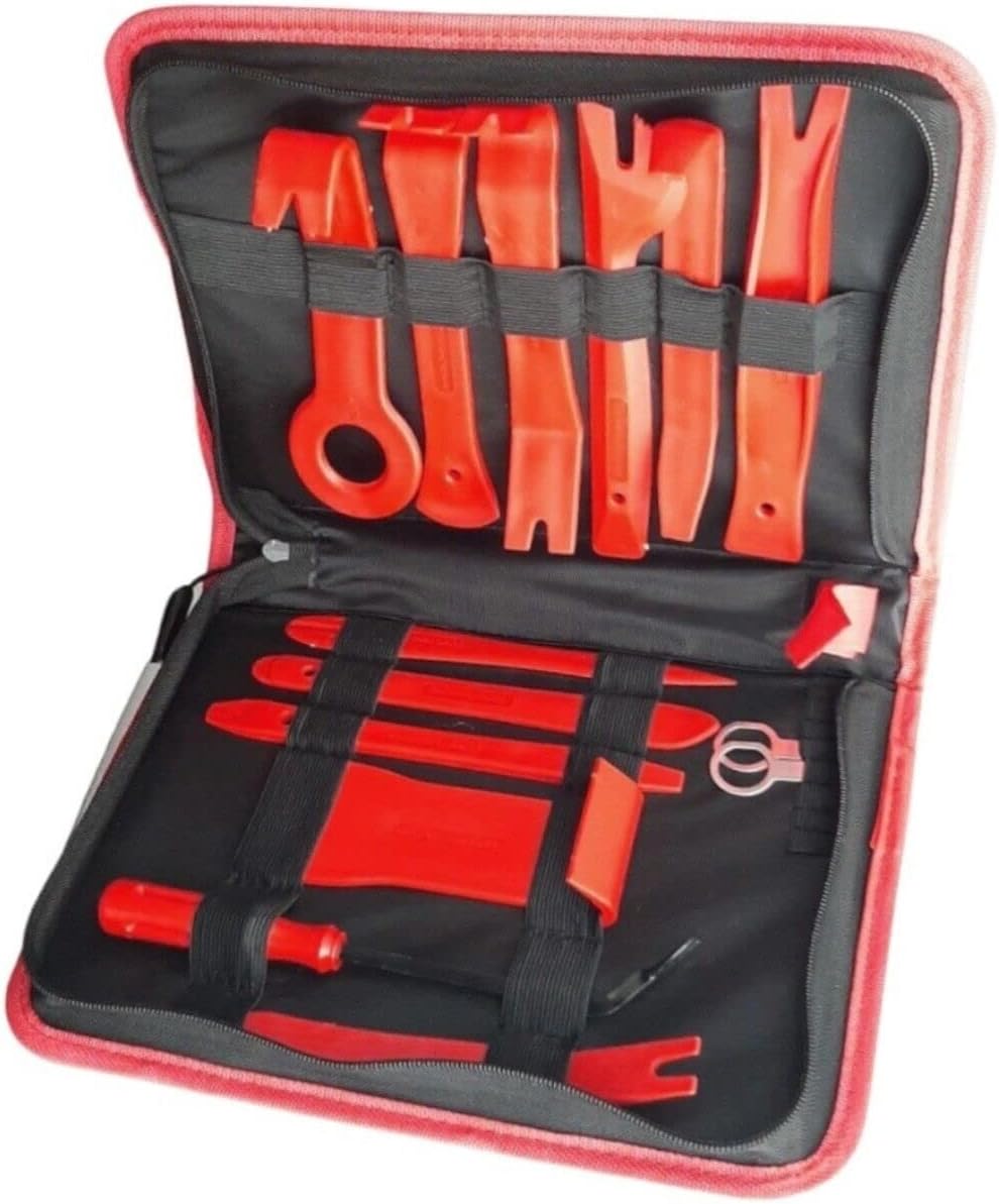

Pingu
3rd Party Trader
Dec 8, 2011
165
The biggest problem is when the clip doesn't break, but the runner on the sillboard breaks.
The solution is to araldite a clip in the correct place.
Judging the "correct" place is not as easy as you think. Don't break two runners, or you have to be very creative and careful how you reassemble it.
A set of these will help save most of the clips...
