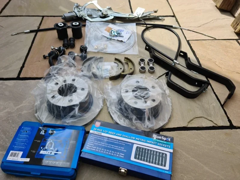

That's what I did. A little order here, a little order there and before you know it you have a pile of newness ready to go on.
Good luck!
cheers ...never done repairs on this scale before but watched tons if videos plus all the advice from here should see me through

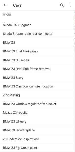

I know I'm not teaching you to suck eggs, but one thing I find I can't do without is OneNote App.. it's how I keep tabs on parts, projects, ideas, costs, progress photos, youtube clips..if I upload and manage on my PC, I can then sync it to the OneNote app on my phone so I have instant access...
