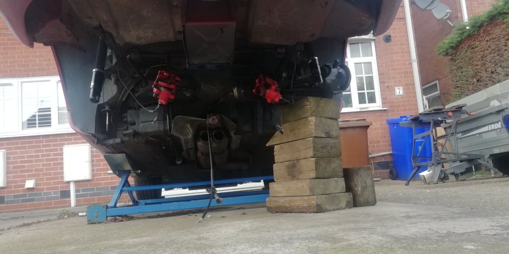

I spoke to the supplier and he told me that they are not rated for lifting the whole care and tilting. One axle had to be on the ground at all times. He said.
That's easily sorted. Blocks of wood and let the wheels rest of the wood.
I put batteries in the boot to make it lift at close to the point of balance, just keep adding cut down sleepers front and rear until the car's at the correct height to work on. Old milk bottle crates would be ideal.
Most of the time I only want to work on one end of the car, so the other end stays on the ground.
The biggest PITA is that the frame is about half an incj taller than the bottom of the car, so you have to drive onto a small ram before you can slide the frame under.

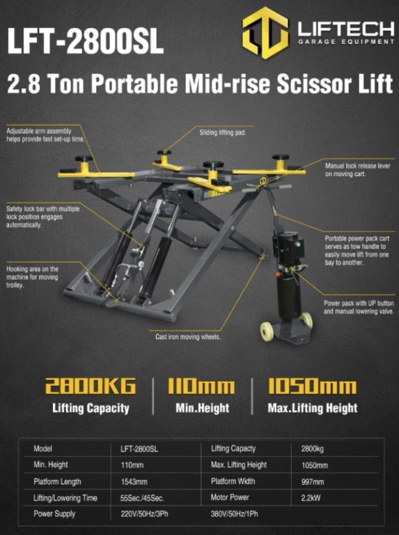

I was considering a tilting lift. But eventually decided on this
I'm loving it.
Perfect for working beside the car. Don't get under it often but when I do I have a couple of long 2t stands that I slide under.

Well in an ideal world I would like one of those too....
however the budget ain't gonna stretch to something that posh :(
