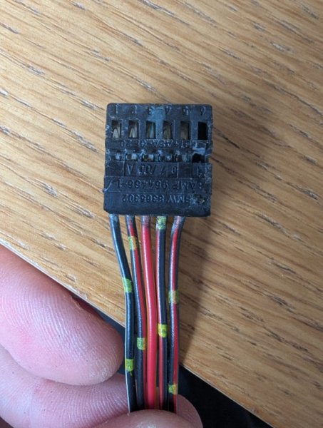

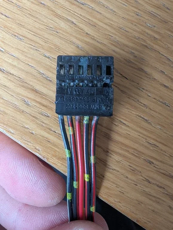

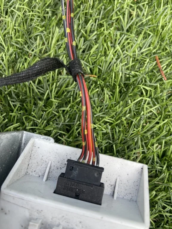

Guys, ended up using the below sensor and wiring from a spare part supplier.
Hope this helps others with the wiring combination.
Seems to fit the above wiring diagram and comments.
