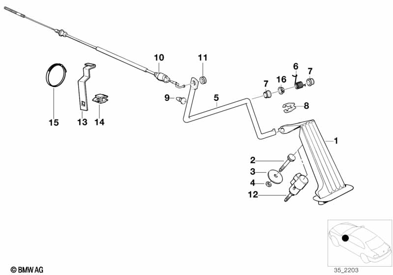

Have a question regarding my 1.9L.throttle cable Driving around today & all of a sudden had no gas pedal.
I thought the cable had broken or the cable came undone at the throttle. The bushing at the throttle cable is cracked & so it's the one at the cable next to it (in assuming this is cruise control cable?)
Should part BMW-35411152331 fit both of these?
Would this be all that I'd necessary to get this end nice & tight?
Turns out what had really come undone was the J hook at the pedal anyhow. Luckily I was able to pull to the side of road and figure this out & get cable back onto the pedal
I used a zip tie to grab hold the end which comes through the cable a little tighter.
Is there a part which locks the jhook onto the cable somehow?
Thanks much

This is for the RHD car, but assume they are similar fixing for LHD
Have you got the grommet?? Part number 11

11 Rubber grommet D=10MM 1 35411152331 $1.17
Mazza thanks so much!!!
No I did not have it there. Going to order now.
