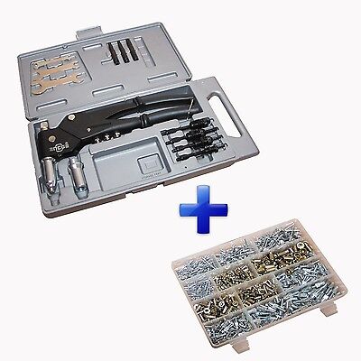

Rivet nuts are common but trying to find an external rivet stud and a tool to go with it proved quite challenging
Eventually came across this on ebay:
Not cheap but it's a quality tool and has worked perfectly -
Just need to grind the old sheared off stud flat and then drill it out and rivet this in place.
NCG Thread Insert Nut & Stud Rivet Gun Riveting Rivnut Riveter & 550pc Rivet Set | eBay
NCG Riveter Set - SWE211. ZigZag Truss. Race & Rally Acc's. 360 degree swivel head hand riveting tool for pop rivets, rivet nuts rivnuts and rivet studs. Rally Design, established in 1972, expanded from a lock up garage to now an impressive 42,000 sq ft warehouse.
