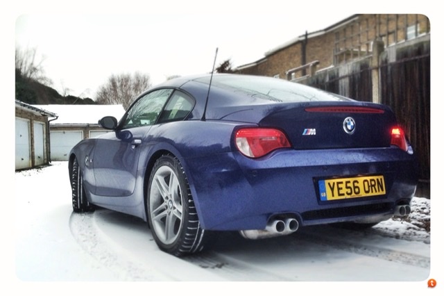

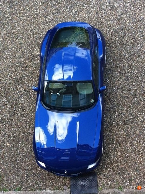

I’ve had 2 x Z4M’s. One roadster, one coupe. Hands down the coupe was the more ‘special’ car and if not mistreated and looked after in the correct servicing schedule, pretty bullet proof. Wheel wise I had the standard M 224’s on (think that was the number), and they were great. If they do swap, most people go for CSL reps or genuine CSL if they can get hold of a set. They really suit the car but I was an oem freak so never investigated (also check Apex ARC-8 and VMR 710 wheels for similar options that properly suit the M).
One thing to be aware of. If you’re parked up for a prolonged period, the battery can drain pretty quickly so recommend a trickle charger and there’s a battery charge point under the bonnet so you don’t have to connect directly to the battery in the boot . Drain may just have been my battery, but I’d heard similar stories elsewhere.
When cold, first gear can be tricky to get into sometimes if you’re attempting to accelerate with purpose resulting in the Kangaroo look! Always wait until the engine is up to temp and some say the removal of the cdv can help with this issue.
Also, the rear shoes can stick to the handbrake drums on the back. Worse if you wash and park with handbrake on, but happens regardless. Solved by a few taps with a rubber mallet to free them up, but I had more than a few high-revving-reverse-going-nowhere moments trying to get her out of the garage before I realised the problem! Park in gear and not with the handbrake on will also help. Apparently it’s the same on E46 M3s.
Anyway, good luck and go for it. Was considering another one myself but not sure I could swallow the £570 a year tax!
Here we mine...
