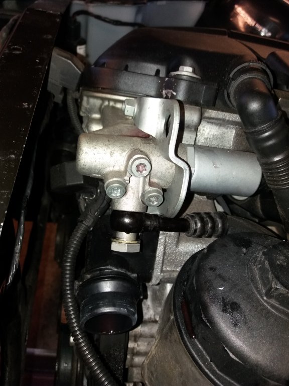

Once the system is empty you need to remove the hose connectors from the T/stat housing, to do this you need to pull out the spring clips which maintain the seal. A smaller flat blade screwdriver is all you need. Pull the clips as far back as you can then wiggle the connectors until they come free of the housing. Then tuck them away from the area. Next disconnect the 2 electrical connections, 1 on the housing and 1 one on the bottom hose connector. Disconnecting both allows you to get the wiring out of the way when undoing the housing screws. By the way contrary to what you might think it is better to position the wiring below the T/stat rather than above.
The housing is secured to the Cyl. head by 4 screws, 1 x 13mm and 3 x 10mm. The 13mm. one also secures the engine lifting front bracket which is also connected by an 11mm. nut on a stud at the Vanos housing.
You need to remove the oil feed pipe to the Vanos by removing the 19mm. Banjo bolt and be careful to collect the 2 alloy sealing washers as you do.
Remove the 13mm. screw and the 3 remaining 10mm. screws and the housing is free from the head. You may need to administer a small tap to dislodge it.

To start fitting the new one I very lightly greased the rubber seal so that it slips into place. When in place firstly fit the 13mm. screw and tighten up to snug fit. Then fit the 3 x 10mm. screws and then you can remove the 13mm. one and replace the lifting bracket making sure you get it on the stud at the Vanos housing and finally refit the 13mm. screw. Evenly tighten all 4 screws then the 11mm. nut on the stud. You can now reconnect the oil pressure feed pipe to the Vanos solenoid, but remember to clean the Banjo bolt and 2 alloy washers and tighten the Banjo bolt.
