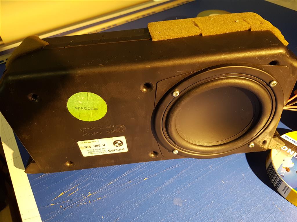

The Problem
The solution.
That's enough for today, I will pick it up again on the morrow.. right now I have go and study the effects of dihydrogen monoxide on ceramics, various alloys,and plastics in a controlled environment...:(

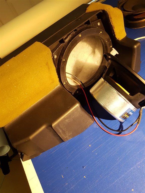

Forward firing going in..
Rear firing in...
Pretty easy really, just got to wrap in foam in a couple of places, and it should go back in the hole it came out of... With the appropriate amount of force...:whistle:. Just a note though, if you do this "observe the phase" the front firing driver has to be polarity reversed... But yeah !!!!!, it sounds like I have tucked away a 12" driver in the boot...

No not boot mounted, It goes back in the space in came out of, the factory one has just 1 driver with 2 voice coils. about a 4"incher. the original driver pionts aft and is in phase with the two behind the seats, with a passive radiator or "drone cone" to the front. a replacement was impossible to get so I upgraded the system with two larger drivers. chucked out the drone cone, wired one driver backwards so it works in tandem with the other one, as opposed to against it with original phase maintained..

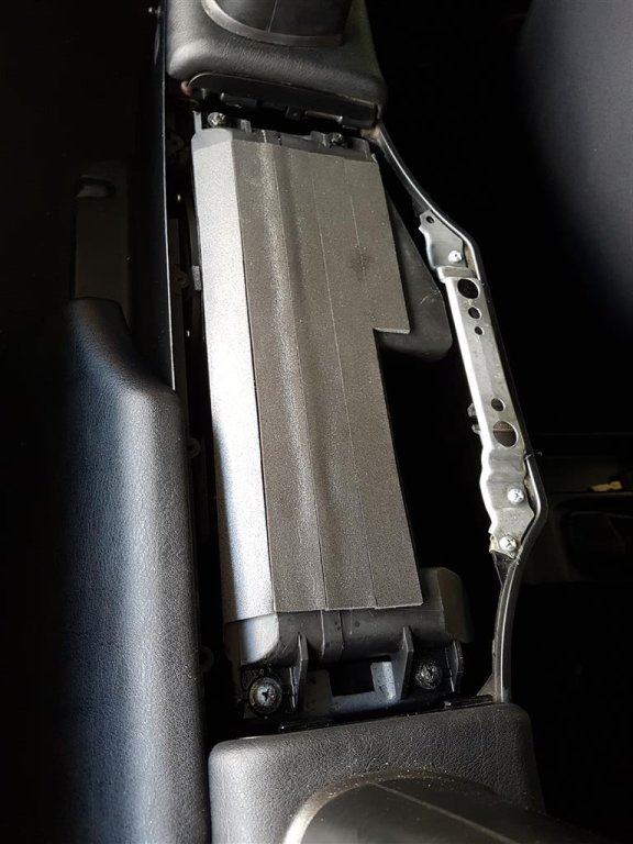

And yes it all went back in the same hole it came out of , just quite a bit heavier,, extra external damping applied to kill off the tupperware box sound.. If anyone else want to upgrade the bass driver without anything being apparent, yell out, Ill walk you through it.. :thumbsup:
