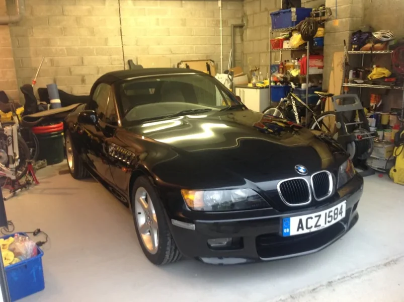

New boots all round...old ones were fine, but noticed they were all dated 2005, so time for a change.
Detailing time now.

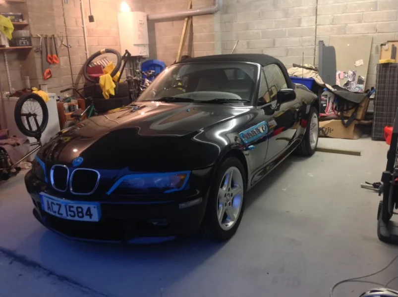

Detailing finished....boy was that paint hard!
Got rid of all the swirl marks, but some pretty deep scratches that won't shift.....or at least I won't try to shift.
Looks good and soooo smooth.
