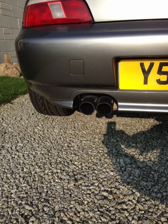

Heres mine.

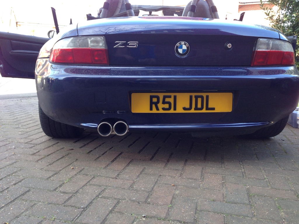

My pipes do fit in the cut out (just) but when you move it side to side by hand they touch the bumper cutout on the sides.
No damage is being done but I think it makes slight noise sometimes when maneuvering hence stiffening the mounts and/or making the cutout wider.
Yours look just as close to the edge Dave, wondering if they also touch or perhaps your backbox is mounted stiffer.
They could also touch and not really make a noise that is noticeable...
Mine is a facelift too, so I will have a look tomorrow and see.

Loads of room :). Makes me wonder if the facelift bumper is more generous with the size of exit hole in the bumper
Certainly seems that way...
IIRC on the facelift they fitted bigger pipes as standard instead of the Pea Shooters the pre facelift 6 originally had.

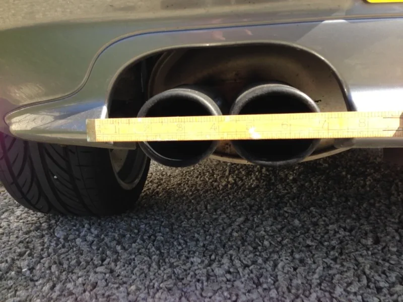

Do you know what size your tips are? I want to switch from the oval to dual duals which are functional and there is such a wide variety of tips available. I like @GazHyde s tips for proportion. JIM
Sorry for the delay heres the size via picture.

Just took a measure and my gap is 6 1/2" on the pre facelift bumper. Has anyone figured out how to run a second pipe off the back box to run dual duals?? Finally got to see @Kit pic and looks like the facelift is an inch wider. JIM

The gap in the 2.8 pre facelift is 17,5cm
