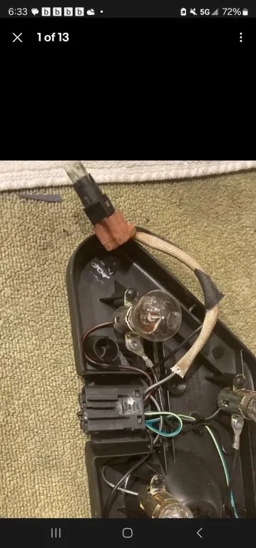

Anyone know where I can get that little black bulb socket in the corner. It has two metal blades that are attached and you push the connectors to. Mine broke when changing the bulbs. Thanks 🙏
Don’t think that’s oem in the uk, looks more like one of the interior centre console bulbs has been soldered in?

Sorry I'm in the USA I guess I should have specified that. Yes I think your right unfortunately it looks like you guys have all normal bulbs we have this tiny one in the corner. HM I can't seem to find it anywhere I look.

EBay, it’s a push in t10 socket. US spec, though it can be added to Euro lights if the socket is drilled out, as I did to mine. I could show you if I knew where those particular rear lights are, stored. . Somewhere.
I just searched “push in t10 bulb holder”. Loads of them, various designs, stupid cheap.

Should be the same fitment as the front sidelights on uk cars as goes into the marker lamp on rear bumper on us spec which is just a coloured plastic version of our clear one wiring would need joining in.

Pretty sure its standard in the USA
