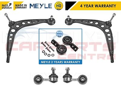

The inner ball joints are also replaceable too. Special tool required, personally I can't see the point with complete arms the price they are though.
When I replaced mine the cost of the tool and the joint was less than a new arm plus there was no need to remove the whole arm and I still have the tool for future use.

They are the failures but to be honest the rest won’t be far behind..you might as replace the lot while you are at it ..you know all is good then.
Meyle HD kit is good

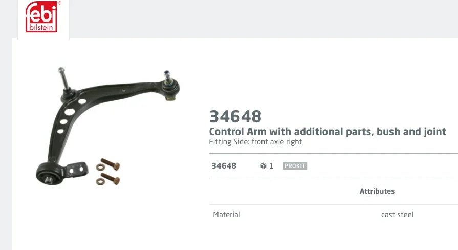

Replace the complete wishbones but use good ones such as Febi or Lemforder.
