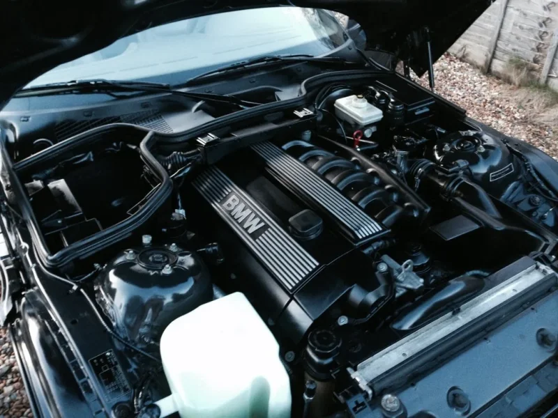

    Evening All
    A very strange one for you...
    Have finally recommisioned the Z after 7yrs in a garage... Got the MOT (no advisories I hasten to add) about to tax it and run it in and well its behaving like a petulant teenager, don't think it wants to leave its nice new warmer garage...
    Started and ran fine on Saturday, Sunday comes, turned key nothing... if you lock and unlock the car before you try starting you get a click from the starter motor and can hear the fuel pump kick in to pressurise the system, however on second attempt nothing... (I hope that makes sense)
    I have checked all the earths, the battery and starter are new (2 months old) and have worked fine until now and battery has been double checked (both voltage and ampage)
    I have got the BMTechic software and there are no faults reporting at all ( I have triple checked before during and after attempts at starting)
    I'm at a bit of a loose end tbh, going to try replacing the battery in the key tomorrow and see if that makes any difference, however the diagnosis software shows that the car can see the key and there are no faults/comments shown.
    I do remember seeing a way of reprograming the key involving opening doors, disconecting battery etc, etc, but can't find it at the mo.
    However any suggestions shall be very much greatfully recieved
    Thanks in advance, help save this z'd from a firey end...
    Jp

    Does the starter motor turn the engine over, if turning over could be the crank sensor not detecting when to fire the plugs, fuel pump relay ?
    From experience there is too much reliance on ECU error codes so I wouldn't play too much into the fact you are not getting any errors. Back to basics fault finding usually works.

    Changed the starter under warrenty as the previous one was giving slightly strange results on cranking. New starter in place, exactly the same outcome, click and nothing... However did notice that normal dash check lights (oil and battery) now weren't lighting up,(well there was a very faint oil warning 'glow'). So checked the battery and it was sitting at 12.2, not low but not great, therefore assumed the car wouldn't start with the battery in the low 12's, so hooked up the jump leads to the diesel bus and hey presto it started... From a check of the alternator readings it didn't appear to be charging at all, therefore took the alternator off and took it to a mechanic friend who tested the unit and it worked perfectly... Put it back on the car and now works perfectly, readings show it is charging well and the car starts almost instantaneously...
    So really no wiser if i have solved the issue or not... Think its just the car wanting to be used more often...

    It has been known for the connections on the battery to be the cause of non starting. The problem with the Z3 is that as the battery is in the boot if you do not have a very good connection on the battery posts you can drop a few volts across the cable run going to the front of the car. This might not show when checking the voltage unloaded but as soon as you try and draw a fair few amps you will reduce the voltage significantly. It is also worth checking the level of the battery too as some after market batteries are slightly shallower resulting in the earth connection being strained as it is a short wire and tries to pull off, some packing under the battery usually solves this.

    Thanks Aceman, that does make sense, as I noticed that the negative connector took some extra 'fiddling' to get the cable to sit/connect properly. After the starter/alternator debarcle I did test the voltage from back to front and found nothing out of the ordinary but was considering that something maybe breaking down under load,
    I'll double check that and the battery height when i get back and then I suppose we'll soon see if an auto electrician is required afterall..

    Good to see it is starting again, so cannot be anything major, you probably had a bad starter and several corroded connections, which you have fixed by taking the bits off and re-seating, fingers crossed now for you

    Looking back on it I'm more inclined to think it was a combination of poor 'new' starter motor and connection issues related to the battery.
    The first thing i tackled was all of the earths and major electrical connections, coming from a background of old VW's I have learnt the importance of Good Earths...

    Thanks Frankie, I've used that one in the past as well, but oddly the lights were staying on with this, which led to this merry go round... Honestly car electrics could drive me to the brink...
    I got back last night and the car started after a couple of worrying clicks from the starter... Played around with the battery connections again (thanks again Aceman) and the car appears to start on the button now, so i'm going to leave it for a couple of days and try again at the weekend, fingers crossed...

    Update time... The car continues to annoy... All connections /cables from the battery to the starter and all of the earths have been checked and double checked, (well apart from where I presume the +ve cable runs through the passenger comparment) there are no fault codes, no current drains and nothing else that would appear out of the ordinary. However it still is refusing to start on its own, a full charge of the battery or a jump and it starts spot on. The starter is fine so the only answer left that i can come to is that I have an alternator that is 'lazy' at best, however before i take the plunge and buy a new one can anyone confirm what their fully functioning alternators are charging at? i've been getting approx 12.7 at tick over to approx 13.5 at 1500rpm, which seem low values compared to other makes I have worked on but want to check before i spend my hard earned penny's.
    Any help would be greatfully appreciated.

    As far as I know they are supposed to be between 13.8 and 14.8v and pretty much the same whatever the engine revs. Dynamo's used to vary a lot with revs which is why alternators became used.
