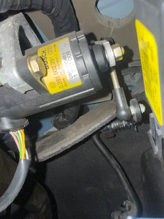

If it's a "fly by wire" throttle (which I think it should be on a 2000 model) it's possible an issue with the throttle pedal itself although you might expect a code to throw up. May be worth removing the pedal and applying contact cleaner on the electrical connections.

OK the trouble codes make sense.
78 (hex), 120 (Dec), Plausibility Pedal Sensor or TPS. When the DME does not know where the throttle body position or the pedal position sensor is, it just cuts the power to limp mode. Usually the engine light comes on and you have to restart the engine to clear the limp mode.
