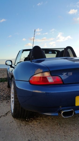

Z3 2.2 Kobra rebody (see pic)
Liking those motorsport rims
