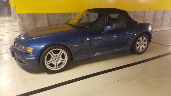

Would this answer the question
The wheels will go on fine on a facelift front offset the same rear different by 12mm I think .
If you want the rears right out at the edge of the aches then they will need spaced but if not the 225/ 45/ 17 front and 245/ 40 / 17 rears are good to go as they are hope this helps.
Stephen.
The same on my 2001 Z3.

Thank you very much! This is exactly what I needed to see. This weekend I'm gonna pick them up :)

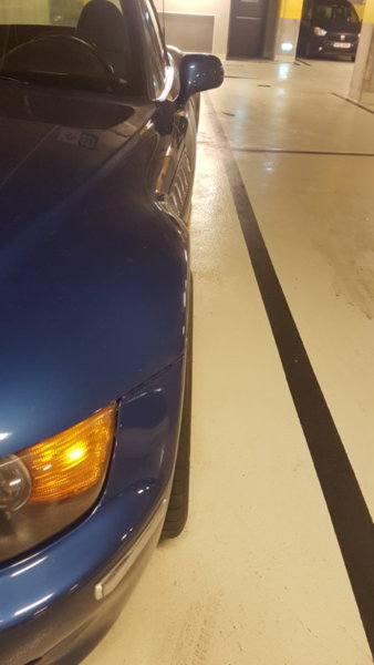

Front wheels mounted :) tomorrow rears.
They are sticking out a little bit, will there be any problems?
Should be fine under normal driving - just don’t attack any traffic calming humps or potholes!:cool: They look great - the rears when fitted will probably need spacers to complement the front.:)

I understand that wheels should not protrude out from the arch/body line.:thumbsup:
