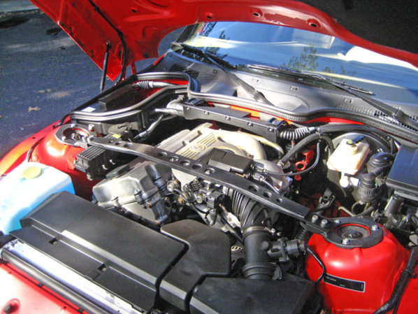

    Their need is the same as a 6. But the throttle body prevents most bars from going straight across over the engine. So all the 4-cyl bars are bent in a bow shape that goes behind the throttle body. They look as limber as a crossbow, being arched in two dimensions:
    http://www.horsepowerfreaks.com/cart/227218
    http://www.cosmoracing.com/productinfo.asp?cid=241&pid=1276
    I had Strong Strut machine the underside of their 6-bar to fit my 4:
    http://i49.photobucket.com/albums/f280/vintagefortytwo/BMW Z3 Related/Strut Bar/SS192_zps992d7f62.jpg
