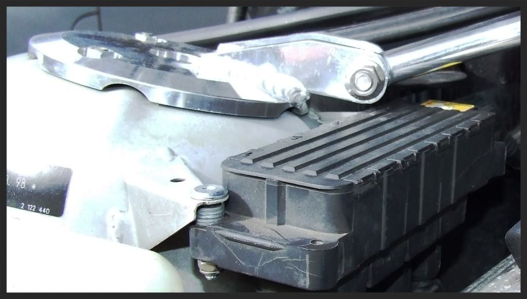

I recently picked up a strut brace for my 1.9... it is curved but still having trouble making it fit...
Brian H
205
Killin
E36/7 3.0i - E85 Z4///M
Some of the strut braces for the 1.9 hit the coil pack, I did a small mod to mine to hang the coil pack underneath the fixings.

Yes. The coil pack is about 25mm too high in my car. I take it your pile of washers is your mod? Neat idea and easy. I take it that it's recommended to bother to fit the strut brace in the first place..? I could find no conclusive evidence of whether it was worth it or not to fit one or not.
Brian H
205
Killin
I found the brace stiffened up the front end of the car nicely, I would ideally have liked to use small tubular spacers instead of washers but it worked fine.
If you go down this route the mounting points on the car have captive studs that hold on the coilpack, I cut these off, drilled 2 x 5mm holes in the mounts and used bolts with nylock nuts & spacers to put it back together.
