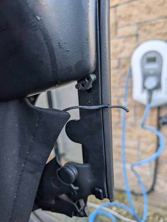

Hi All, I have a manual roof on my 1999 Z3... I just noticed that the soft-top retaining thread has become detached from the spring that holds it. It looks like the end has actually broken off the black string. I guess I could just tie a knot in it, but that would make it shorter and put...
No mate ..takes 5 mins. You need to unscrew the bolt that holds that metal bit the new string goes through. Just have to peel back the rubber seal (arrow)
It’s the liner tensioner you need not the roof tensioner which is a metal cable
